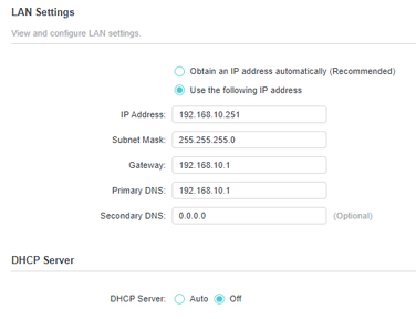

You might find the Hub two does not list devices that it has not allocated IP Addresses to, my suggestion would be assign the WPA4220 an IP Address in the DHCP pool range, the Hub will not allocate another device to that IP as it recognises it has a Static IP Address, you need to make sure the IP you select is free
I have changed my network to 192.168.10.0/24 DHCP pool is .64 to .253
HTH

This is my IP settings
The Hub Two will show it as my previous post.
You will be using 192.168.1.n IP Addresses with the Hub using 192.168.1.254
Edit: once you have the IP setup you can use a browser to manage it
