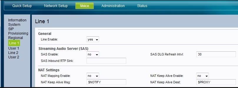

bromleyboy21
Posts: 8
Thanks: 3
Registered: ‎20-01-2024
Re: Problem with receiving incoming calls on Andrews & Arnold VoIP
Thanks for finding this extra info for me.
Can I just confirm that I'm ignoring the SAS Enable and saying yes to NAT mapping and yes to NAT keep alive?
Many thanks
Ed
Posts: 19,481
Thanks: 8,558
Fixes: 558
@bromleyboy21 yes , I believe you should ignore the SAS enable.
TBH the voip hardware Ive seen previously only has one option which is usually NAT keep alive. Im not entirely sure what the NAT mapping enable does in your case.
I THINK that you should try with both NAT mapping enabled and NAT keep alive enabled. If that doesnt seem to work then try with just the NAT keep alive enabled.
You can leave the Keep alive msg as $NOTIFY and Keep alive dest as $PROXY (I think!)
According to this tortuous thread: https://community.cisco.com/t5/voice-systems-and-accessories-small-business/nat-mapping/td-p/3896301, the NAT Mapping Enabled = yes) causes the WAN IP to be discovered by some mechanism (e.g. STUN).
"Exact behavior depends on the configuration of other NAT-related options and/or data discovered during STUN (if enabled)."
