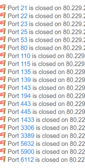

Firewalls are in place to BLOCK INBOUND connections to a private LAN from the Internet and I would expect all the commons ports to be closed unless a port forward rule has been setup. My Members Centre Firewall is set to LOW and I see these common ports closed.
If you have a port forward rule set up then the device to which the port forward rule is pointing must be listening for connections.

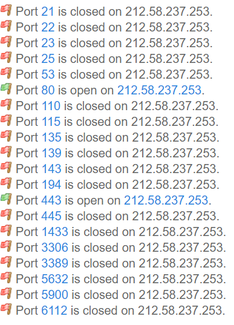

A shields up check for www.bbc.co.uk you get.
For the BBC Port 80 and 443 are open for http and https connections.
I use WireGuard VPN running on a raspberry pi it uses UDP and works very, I'm not using the default port of 1194.
Dan.
