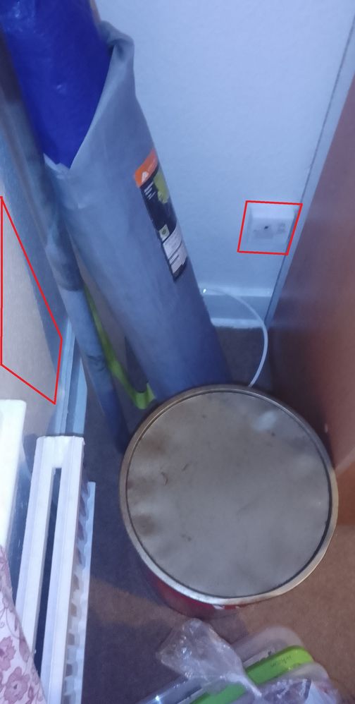

Hi all, thanks for the replies. Wish it was a 1.5m power cable from ONT to plug Sad
Please see photo below: the left side is the outside wall at rear of house, window above radiator. We were hoping engineer could drill through outside and put ONT box someone in the red area I have drawn on the left outside wall, just to the right of the radiator and window. We only have the one plug socket available next to the (very heavily filled) wardrobe.
So:
a) Do you think if ONT could be fitted here, the power cable would reach the single socket?
b) The white cable you can see is from a security light that is drilled through window frame with a plug on the end, but will give way to the new ONT box.
c) Is there enough room when we move all the stuff out the way between the left wall where we'd like ONT box and the wardrobe for an engineer to work? We really don't want to have to empty this wardrobe but I personally don't think there is enough room for the engineer to pull a cable from outside into the room and fit the ONT box
Otherwise we have to totally empty and move the wardrobe so he can work, and/or get an electrician to convert single socket to a double one, then security light can go in left side, and ONT power lead in the right half.
BTW the Plusnet router is going on a shelf in the entrance hall, so we will be needing a long ethernet cable / lead from the ONT box, along the skirting of this box room, outside the door to the landing, then down the first few stairs to a shelf on the hall wall.
Why is it so complicated?!

Posts: 14,582
Thanks: 7,481
Fixes: 476
Re: Openreach ONT box power lead
@andyt1970
This might be a bit tight but I would not expect it to be much of a problem. The hole is drilled from the inside out. The internal fibre has a ready terminated connector so is again installed from the inside out. Regarding the ONT lead, as @Dan_the_Van points out, extensions are both cheap and readily available. See: https://www.amazon.co.uk/Multibao-Extension-Cameras-General-Electronic-1-M/dp/B0B7675MSF/ref=pd_ci_m...

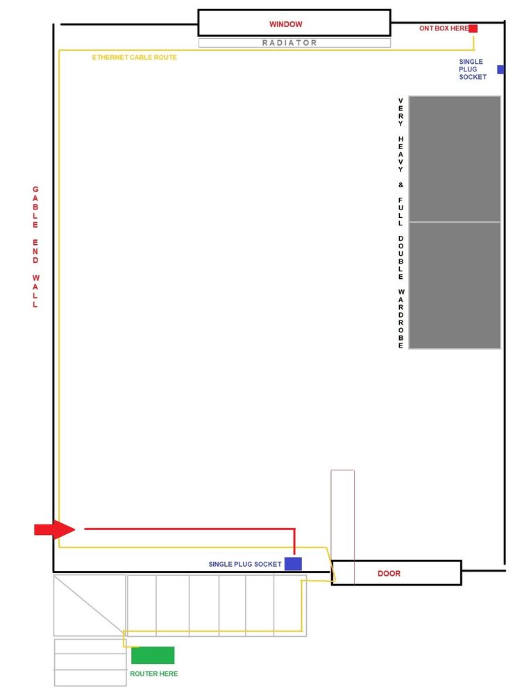

Thank you, good to know. Just don't want engineer to turn up then say "No, can't fit it, make another appointment" and disappear Sad , leaving us to make new appointment for a further 4+ weeks. We wouldn't be able to empty it and move double wardrobe in 10 minutes even if he waited Sad
Rough room layout below if it helps?!
Posts: 5,801
Thanks: 2,150
Fixes: 115
@andyt1970
The question to ask yourself is - could you fit a drill with a long bit into the space between the wardrobe and the wall?
A simple power extension would work short term if the power lead doesn't reach.
As the installer has external work to do I'm sure you could get yourself 10 minutes of so to empty and move the wardrobe or you could just bit the bullet and do it before hand.
Of more interest at the moment is where is the current master socket in relation to wher you want the ONT. Is it on the same external wall?
Is the router going upstairs or downstairs in the hall way?
If it wasn't for the terrible state of the crumbly, seriously damp penetrated gable end wall, having it come in at this point (see red arrow, below) would be great, but then how would the power lead from the ONT which he'd install on the inside of the gable end wall - reach the other single power socket if it's only 1m long?.
But it would mean less ethernet cabling to do to get out the room, along landing and down first few stairs.
