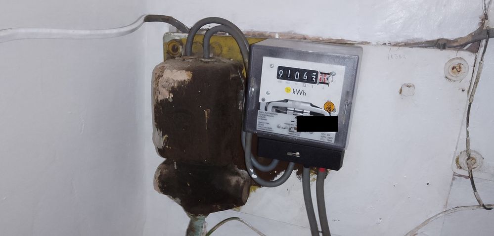

This was the old ancient electric set-up in the pantry:

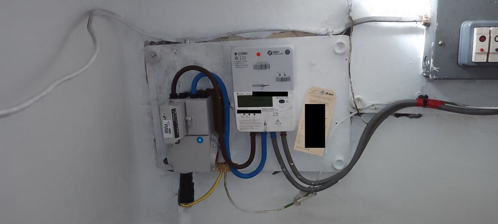

And this is after ENW put new connection into house and the grey "box" in the Spring, plus also a new EON fitted meter after ENW had done.

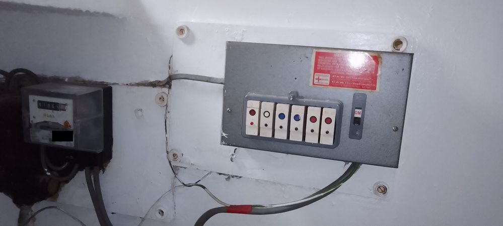

As you can see the fuseboard / consumer unit is ancient and the electrician said he wouldn't bother putting a new one in "as it would be too sensitive and keep tripping".
Apologies the photo below is still with the old meter but shows the same fusebox we have.
I'm surprised that the electrician didn't stick a 'condemned' label on the installation.
Whilst the BS 7671 regs are not required to be retrospectively met, false tripping suggests failing insulation and time for a complete house rewire.
If the house was to come on the market or be formally let I would question whether it would qualify for the nesessary electrical safety certificate.

@andyt1970 wrote:
What installation? The new electricity supply entry point done by Electricity North West ( ENW) and meter installed afterwards by E-On? Don't tell me that's bad
No, not at all.
I was referring to the comment that replacing the ancient fuse box with a modern consumer unit would cause false tripping.
If you are not aware, modern consumer units incorporate devices that trip if there is any leakage current. This is a safety feature designed to protect people who get an electric shock by switching off the power quickly if leakage current exceeds a dangerous level.
If there is already this level of leakage due to wiring of a similar age as the fuse box having deteriorating insulation, then it’s potentially dangerous.
