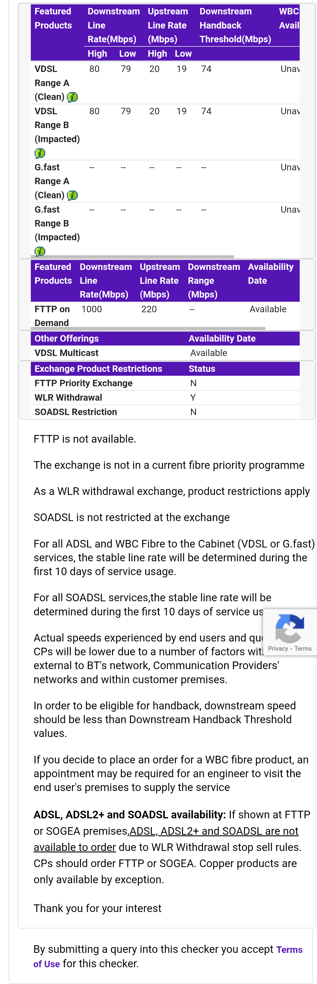

Just to check what's available can you post a screen image of the results from the following (after hiding your details). Make sure you include the narrative below the results window.

Attached, it says FTTP not available but everyone around me (apart from the flats) can get it and on the same cab.

Full Fibre is not available to you at this time from OpenReach. You need to see WBC FTTP in the left hand column.
You could use the Address version of the Checker to see if any of the other flats can get it.

I believe you need to show FF is / should be available to your flat (and the others). No point in chasing the freeholder if it isn't available for some technical reason.
To do so build up some evidence. What does www.openreach.co.uk say for your flat if you put your post code in? Check both neighbouring flats and surrounding properties for evidence.
Then use the Address version of the Checker for your post code. If you're minded to you could look at every property in the post code. You need to see WBC FTTP in the left hand column and available to the right (or KCI2).
It might just be a database error with your flat.
