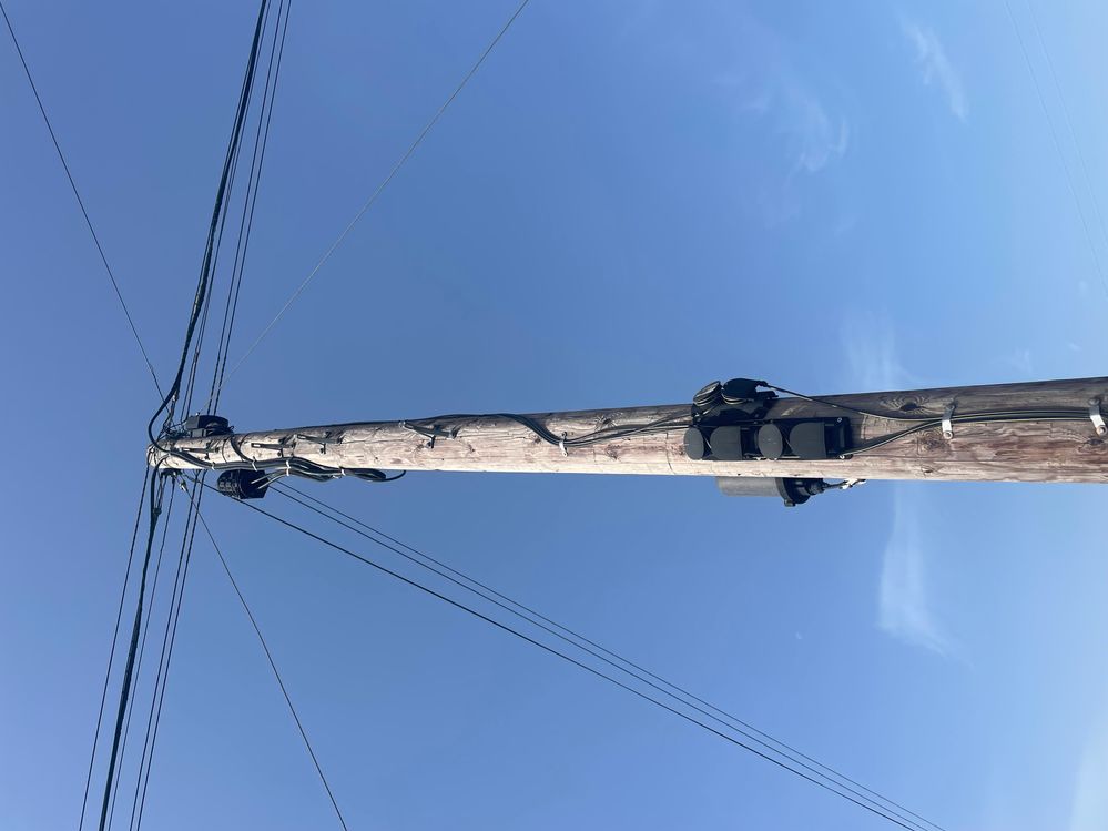

Recently some new apparatus has appeared on the pole in the lane outside our ground. Someone mentioned to me that they believe these are “fibre pods”?
My question is:
a) is this indeed fibre apparatus ready for a connection?
b) how can I best find out if or when a full fibre connection might become available to us?
Thanks very much for any assistance… FTTP would be the answer to my prayers to solve what is a very frustrating experience.

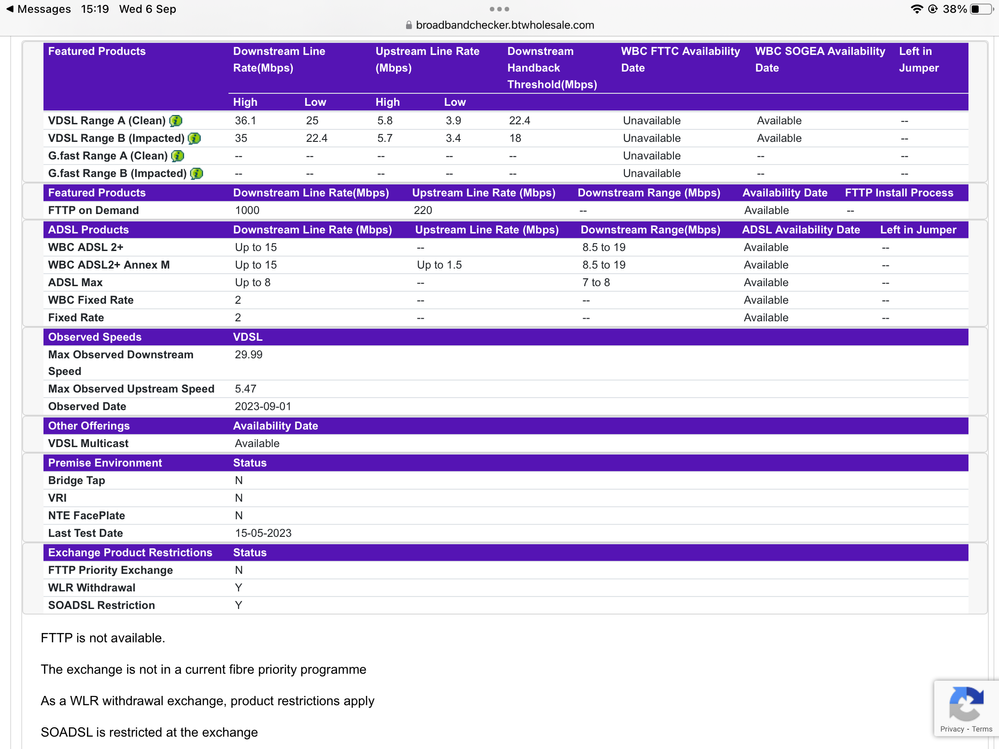

Put the phone number in here. https://www.broadbandchecker.btwholesale.com/#/ADSL
You are looking for the availability of WBC FTTP

These are the results I get. How to interpret these?

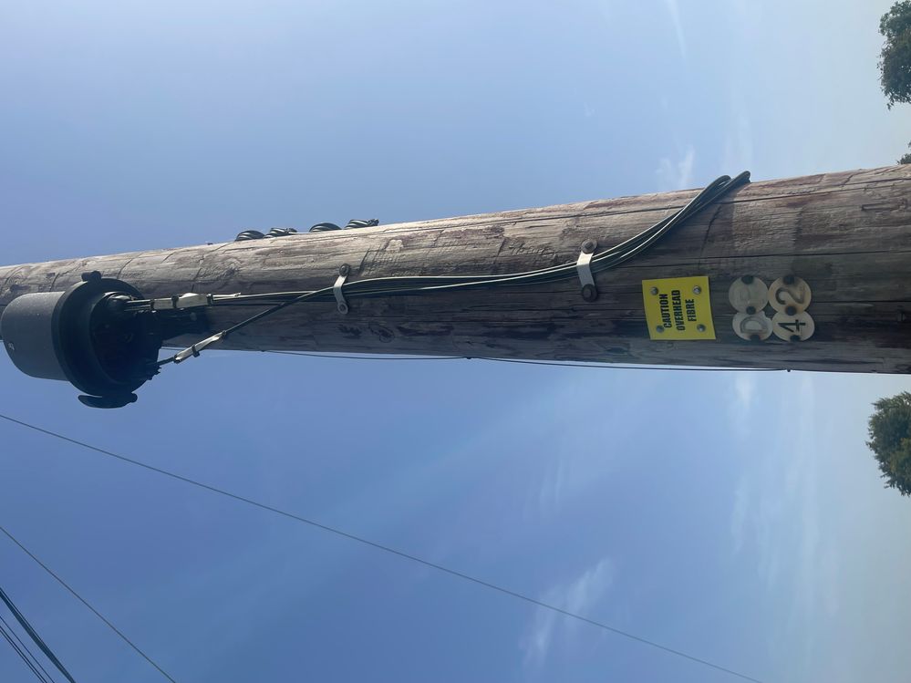

Now I’ve sussed how to upload photos, this is the pole outside our premises, if that helps!?
Does this offer any grounds for optimism that a full fibre connection might soon be available?

FTTP is not available to you at the moment.I'm not familiar with the hardware but it looks to me like it's on its way. What do you get when you enter the postcode here?  https://www.openreach.com/broadband-network/fibre-availaility

If or when FTTP becomes available to you you'll see WBC FTTP in the left hand column of the Checker.

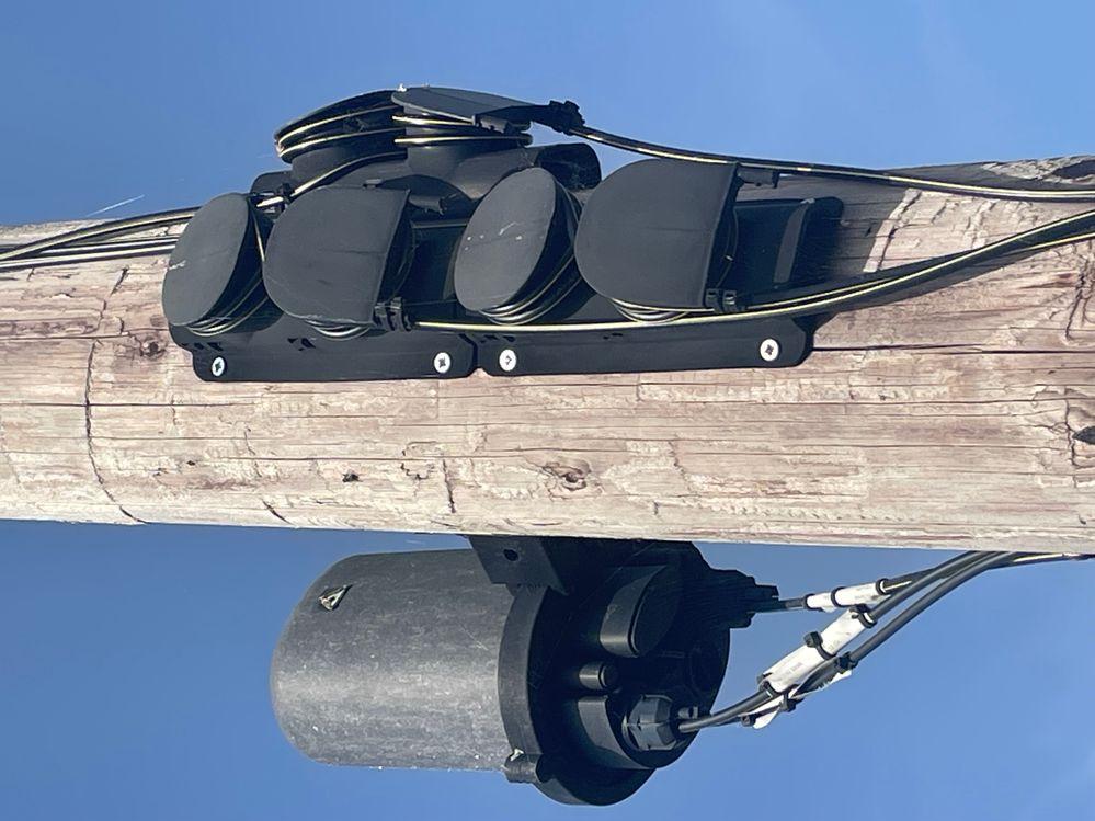

@MCC1969  There is certainly a fair bit of Full Fibre hardware showing on that pole but it is not showing available on the BT checker. There are a number of possible reasons.
1)  It has been installed by Openreach but is not yet in service, when it becomes available Plusnet will be able to supply but I wouldn't expect them to offer it to you automatically. You may have to check your account to see if an upgrade is available.
2) It is not an Openreach network but an alternative fibre supplier (Alt-net) using Openreach poles in which case Plusnet will not be able to supply, you would need to find out which ISPs use the Alt-net or they may also be an ISP and supply directly.
3) An Openreach database error, do you know if other properties supplied by that pole have FTTP, you can enter the post code in the address version of the BT checker and it will give list of addresses to check. There is an Openreach form to enable you to enquire why FTTP is not available to you but nearby neighbours can get it.
Are there any details visible on the fibre nodes ( the large cylindrical casings) mounted on the poles if you can manage to read them?  Near my location there is an Alt-net installing on Openreach poles and their name is shown. I was wondering why there was no Openreach fibre showing in the area.🤔

Plenty of fibre apparatus on the pole but I don't see anything 'TTP' related,  i.e. no CBTs seem to be present.
It seems to be fibre which is just 'passing through' ATM.
