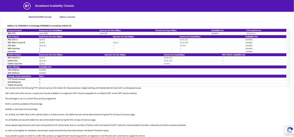

Re: Home lab

Re: Home lab
@Halfhidden
You probably should have hidden your address from the results.
Assuming the phone version of the Checker says the same thing then any ISP that offers FTTP using the OR network should it as being available to you via them.
