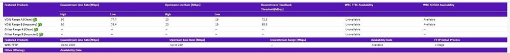

What does your BTw checker say, Dan - I'm going on what was displayed on the OP's result.

In answer to your BTw question.
The exchange is not in a current fibre priority programme
I am on a 18 month Unlimited Fibre Extra contract started mid Nov 2024. Until the last couple of weeks SoGEA was available as as an upgrade. Now it's only Full Fibre.

Having been thinking through this, I was left wondering which 'exchange' the 'Availability Checker' refers to ?
In my vicinity there are three conventional telephone exchanges, roughly in a straight line, in separate villages, maybe five miles apart. Lets call them 1, 2, and 3, and are nearest, middle, and furthest from Openreach's London datacentre.
- Exchange #2, provided the original copper wires for my landline phone and ADSL.
- Exchange #3, is what feeds my FTTC cabinet and therefore my current broadband connection.
- Exchange #1, appears to be the centre from where the expanding FTTP deployments are originating, and likely to be where I will eventually be connected.
In the BTW availability checker, it is showing my exchange as #2 despite receiving no service from there, as I only have SoGEA via exchange #3, but when FTTP appears that will be from exchange #1.
Therefore the checker results table is only an indication of what services are available at my address, and any mention of 'exchange' in the notes below appear to only be an indication of the state of exchange #2 which is irrelevant as I don't take any services from there, as opposed to the actual exchange from which the associated named service would have been sourced from.
