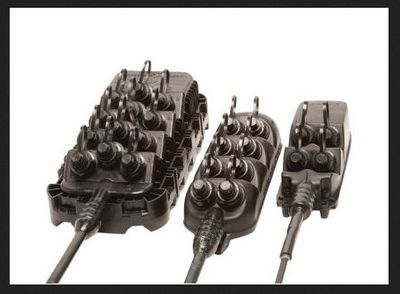

Next question - does the pole have a CBT fitted?
https://community.plus.net/t5/image/serverpage/image-id/62172iE589C1E9E4C613BF/image-size/medium?v=v...
The number of ports depends on the number of properties served.

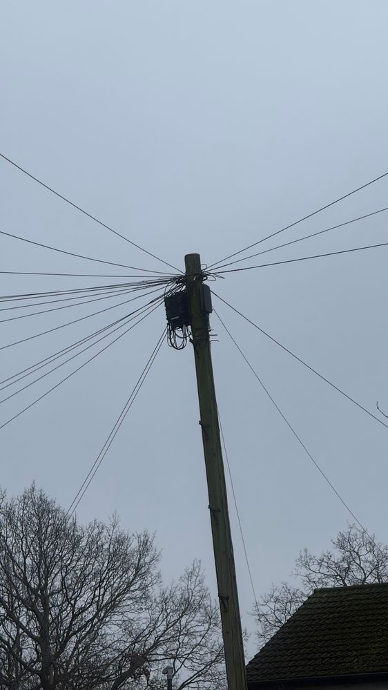

I think so. An extra box was added maybe a year or so ago. I can’t see how to upload a photo here.

Thanks for the image. I'm afraid I can't tell if a CBT is present or not. Now you know what to look for I think next time you're out you need to have a good look.
Full Fibre doesn't run to the nearest cabinet - it goes directly all the way to a Main Exchange (which may not be your local one). What to do is to use the Address version of the Checker and look at the houses connected to the pole which serves you.
