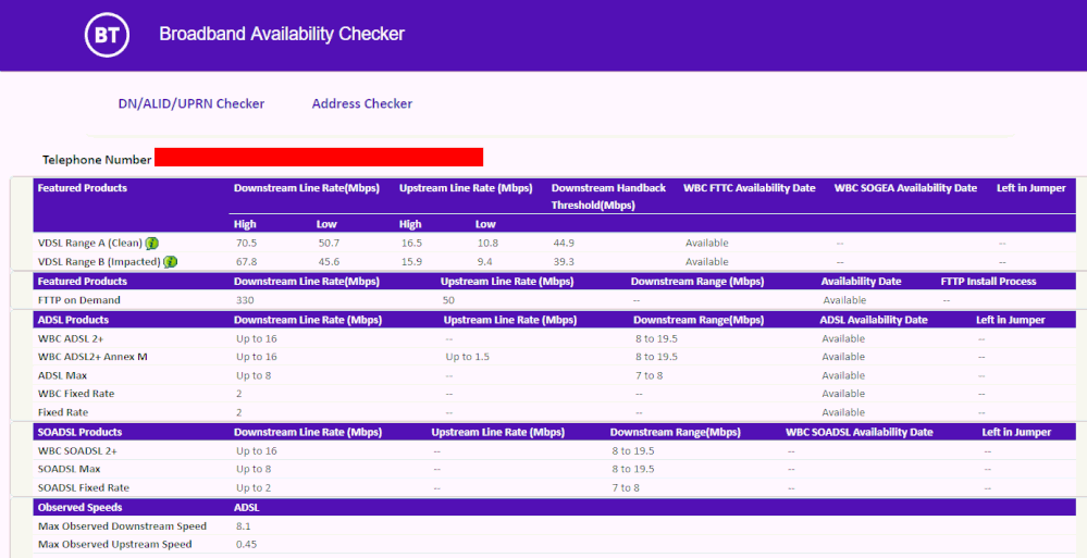

I told the Post Office before their supposed upgrade day that they should either tell me how I needed to reconfigure my modem or not go ahead with the upgrade, and that whatever happened I wasn't going to use their modem. They asked me to return it, which I did, and they advised that on the basis of what I had told them about my modem (which was limited solely to what downstream bandwidth it could handle - nobody mentioned the word "ADSL") everything would be OK with my existing modem. Then since upgrade day I have been unable to get online through my landline. All they could tell me when I called them was my PPP username and password, and not only that but they were arsy and said they didn't have full details about every single modem. I have repeatedly told them by email that reversing the "upgrade" would be fine as far as I am concerned, but they have ignored this suggestion. This and a few other things mean that I have absolutely had it up to HERE with the Post Office. I've heard good things about both PlusNet and Zen and everything being OK I will change to one of them.
Since the mobile phone signal is so poor in this area, I can't set up a hotspot using my smartphone inside the house, so I am having to go outside and sit in the car to get online. And this may be the position for 10 days - argh!

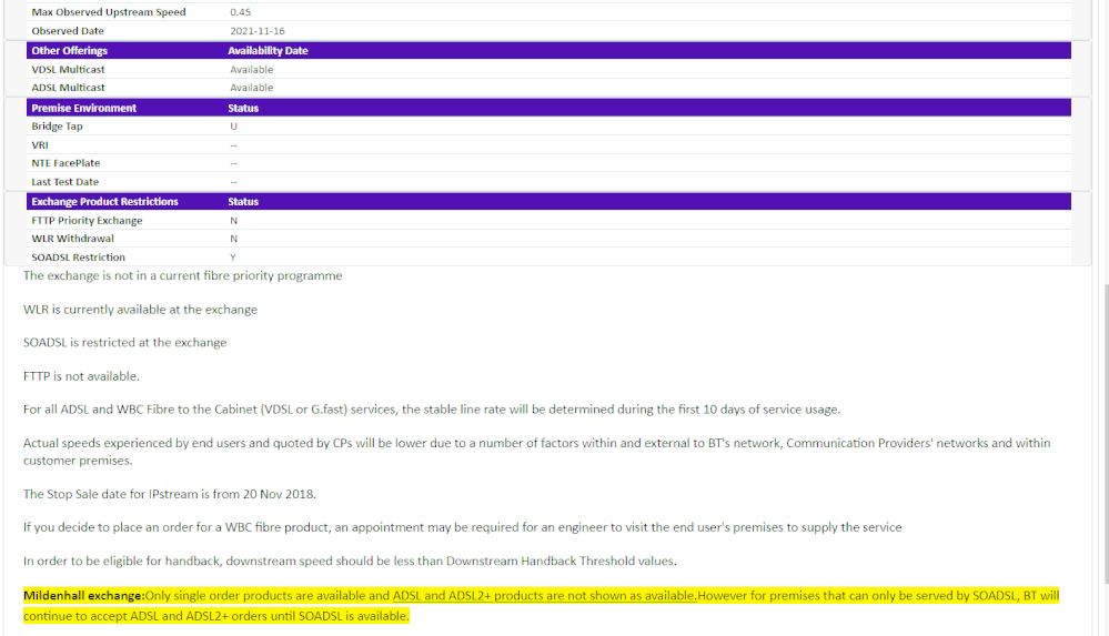

I was going to mention that somewhere deep in the grey matter I seemed to recall that BT Retail had stopped selling ADSL products unless there was no other option. Your screen image would also suggest my memory isn't totally gone.
I also recall that Mildenhall is one of the test exchanges for the withdrawel of services based on copper lines. As such, ADSL is no longer available to you. You have to go FTTC.

My exchange isn't Mildenhall. It's named on the line after my telephone number, but I blanked it out because the name is of the village where I live on this Scottish island, and it's a very small place.
If ADSL is no longer available (although it was until a few days ago), then I will buy an FTTC modem/router (hopefully the combined item exists), which may at least mean I can get online from the house before the 10 days elapse, but I will switch away from the PO because I have had enough of them.

Sorry, I assumed Mildenhall as it had been highlighted in your screen image. The following details what's happening in that Exchange.Note that other Exchanges are now involved and OR are working to cease all ADSL lines.
https://www.openreach.com/locations/mildenhall
Of course, had I actually looked at the results I would have seen that ADSL is in fact available. If the Post Office are migrating services to FTTC then it's prossible you do have an internet service, just no FTTC (VDSL) modem/router.
