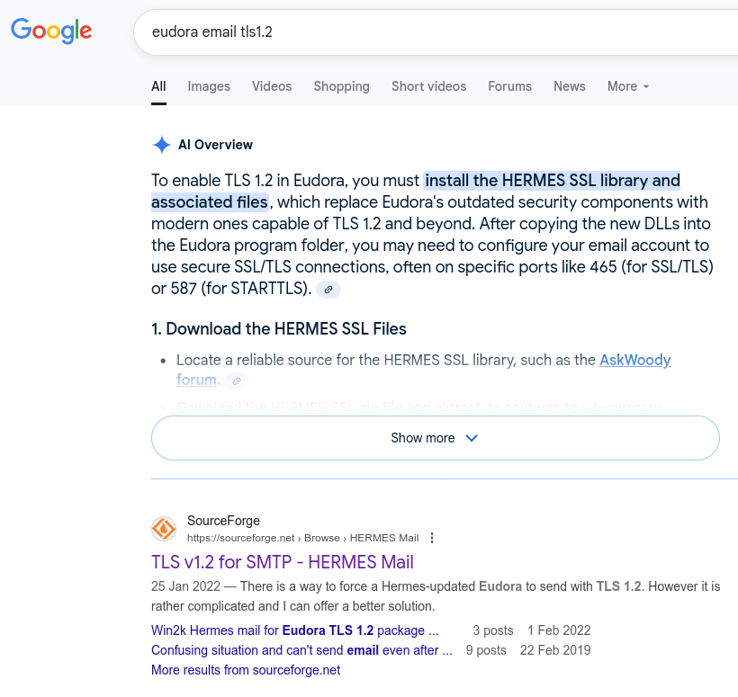

Here are the Hermes files - https://sourceforge.net/projects/hermesmail/files/
The underlying problem with Eurora is that it is using TLS v1, and requires patching to get to a minimum of TLS v1.2.
I'm wondering whether this is a migration consequence of moving Plusnet email to Greenby,  where Plusnet which hasn't been maintained for years probably still functions with TLS v1, whereas almost all email providers now enforce a minimum of TLS v1.2.
Therefore is likely to cause issues on Greenby for customer's who have old PC's that haven't been updated to TLS v1.2.

Ah, Google obviously doesn't like freeware/shareware sources.

No, you just searched for the wrong thing, as the link was the first result Google listed.

@outcast Following that link in the AI generated response - which is a link to Googles search engine takes you here: https://www.google.com/search?client=firefox-b-d&sca_esv=e7bf22627bcd1c5c&cs=0&q=HERMES&sa=X&ved=2ah...
Admittedly, there are a number of pages following, but if you are searching for the information requested by @MisterW , that, and not clothing/logistics, should be reflected in the primary results page. IMHO, of  course.
