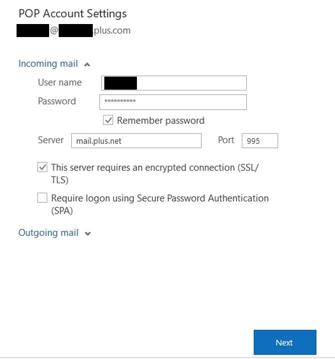

As well as the Plusnet email breakdown there has been a recent update to Outlook, which could be your problem. These POP3 server settings work for me:

Thanks for your settings, but I see you are not using a login to access relay.plus.net. So you would not be able to send email while not using your plusnet connection. My problem is that I cannot login to relay.plus.net on either my PC with outlook 365, or my ipad or iPhone using mail away from home. I know all of the settings are correct. I have been through them with plusnet tech support. So either both outlook 365 & iOS have developed the same problem at the same time, or more likely, there is still a problem with plusnet mail servers.
