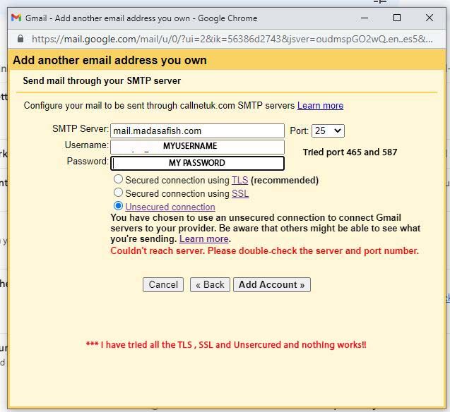

Deepmind
Posts: 9
Registered: ‎15-05-2023
Re: Problems using Gmail client to send email through relay.plus.net
GMAIL ADDMAIL SETUP WINDOWGMAIL ADDMAIL SETUP WINDOW

Deepmind
Posts: 9
Thanks. tried that and it does not work.
Error Message: **Couldn't reach server. Please double check server and port number..**
