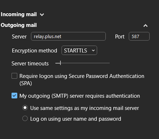

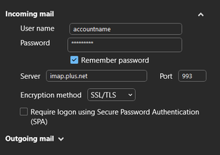

These are the recommended setting
IMAP: imap.plus.net port 993 encryption SSL/TLS
POP3: mail.plus.net port 995 encryption SSL/TLS
SMTP: relay.plus.net port 587 encryption STARTTLS
User name (authentication) configured on BOTH incoming and outgoing servers
Default mailbox accountname
Secondary mailbox accountname+mailboxname
If you've been with plusnet a while, your domain might be '.force9.co.uk or '.free-online.net'.
If so, change '.plus.net' to '.force9.net' or '.free-online.net' for both your incoming and outgoing servers
Server setting for plus.net would be:-
You should receive a test confirmation email
HTH
