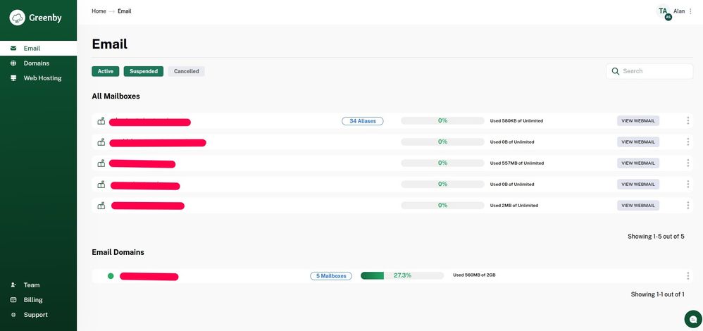

My migration appears to have gone smoothly apart from an old codger forgetting his password to his account, luckily Google came to his aid, but I'm still getting some emails from a Domain which the system says contains a virus, I blacklisted the Domain on Plusnet & they stopped arriving. I asked Greenby AI how to Blacklist the Domain & was advised I should have options for
Greenby Dashboard (Client Area) - https://greenby.com
This is where you manage mailboxes, filters, domains, billing, settings
This is where you should see: Mailboxes, Forwarders, Filters, Settings under the Email section
I don't have these, eventually AI gave up & said I needed to talk to an agent & would transfer me, I gave up after 30 minutes, so thought I'd ask here. This is the screen I see, is it different to yours, or is it the same & AI is wrong (shock horror)

@Phaeton I cannot see your screen yet, but does it have a heading of Welcome, with buttons for Tickets, Invoices and Domains?
If so, underneath there should be an area of Recent Products, which includes Email - Connected and your domain name.
At the right is a Manage button - click that and you should see the screen you are looking for.

Indeed the portal is not overly intuitive. On the approach of "kick everything everywhere until you find what you what" ... the screen I believe you are looking for is "behind" the email domain link at the very bottom.
I will also approve the image so others can see it.

@Townman Ah I have found I need to click the Greenby logon in the top left, then click on Manage, which then gives me all the options.
