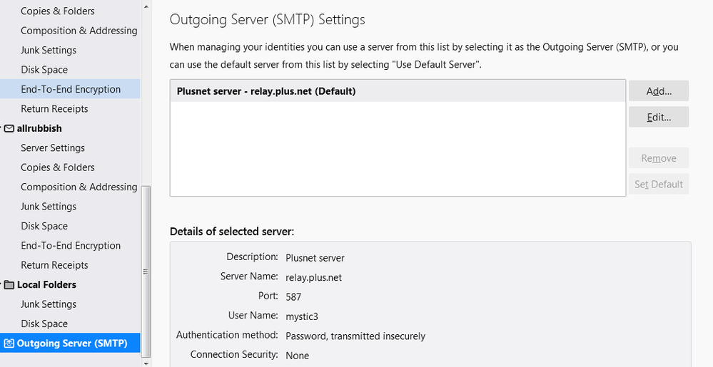

Posts: 22,755
Thanks: 7,959
Fixes: 334
Re: Using Thunderbird and Cant SEND mail
@LizMac42 'That' being my suggestion of making sure the server is correct, then make sure it looks EXACTLY like this:
