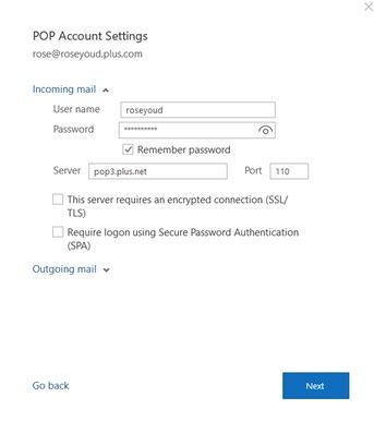

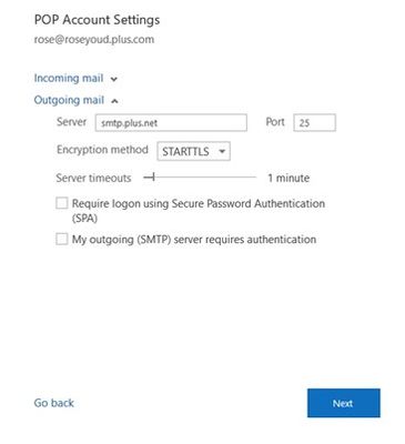

Since I was forced (i.e. against my will!) to give up Outlook 2010 in favour of Office 365, I can only access email account settings via a 'manual repair' option ... The settings that Outlook insists on inserting are as follows:

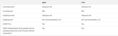

These are different to those recommended by Plusnet:
I've tried to manually change the settings to the Plusnet ones but they won't just save ... I've also tried setting up the Plusnet email account again using the Plusnet settings - but it won't work!

@jjlothin - the correct setting for the outbound server are...
relay.plus.net port 587 STARTTLS
Using smtp.plus.net and port 25 will work, however, (a) you are likely to encounter certificate validity warnings and (b) port 25 is for MX to MX message transfer, not message submission.
