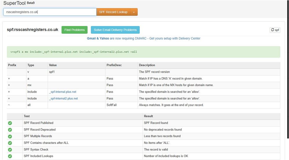

Black_Shuck
Posts: 22
Thanks: 6
Registered: ‎17-07-2018
Re: Gmail rejecting Plusnet mail
OK, the SPF is active on the test website, but still bouncing emails back from Gmail.
What am I doing wrong?

@Black_Shuck you are using relay.plus.net as your smtp server ?
Black_Shuck
Posts: 22
Thanks: 6
Yes, relay.plus.net.
Posts: 20,411
Thanks: 9,252
Fixes: 585
It's possible that the DNS change hasn't propagated fully yet, so gmail's servers aren't finding the SPF record.
What's the exact error that you're getting when sending to gmail ?

Black_Shuck
Posts: 22
Thanks: 6
It's there & working but emails still bounce.
What email settings do I require please?
Posts: 20,411
Thanks: 9,252
Fixes: 585
You should need nothing other than setting your outgoing server to relay.plus.net , using port 587 with STARTTLS encryption
Which of these smtp error messages https://support.google.com/a/answer/3726730?hl=en are you getting ?

Black_Shuck
Posts: 22
Thanks: 6
Reporting-MTA: dns; avasout-ptp-001 [84.93.230.227]
Received-From-MTA: dns; [192.168.1.73] [212.159.61.154]
Arrival-Date: Thu, 05 Sep 2024 13:15:58 +0100
Final-recipient: rfc822; [email protected]
Diagnostic-Code: smtp; 550-5.7.26 Your email has been blocked because the sender is unauthenticated.
Last-attempt-Date: Thu, 05 Sep 2024 13:16:01 +0100
