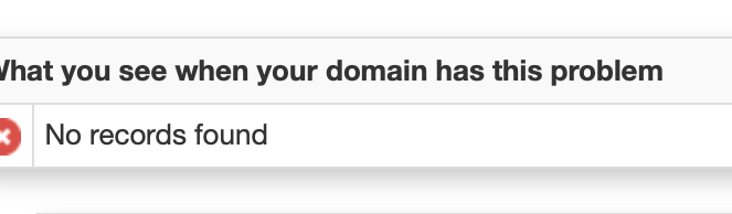

@aimless101  you have a space in 'please-add -spf-records' between the add and the -spf , remove it and try again.
You can check if your domain has an spf record by going to https://mxtoolbox.com/ , enter your domain and click the MX lookup button. When it gets the results , use the dropdown arrow now there on the button, select SPF record lookup and click. That should return the SPF recrod if you have one.
Note it can take up to 6 hrs from adding the MX 999999 record

Re: Cannot send to gmail addresses
Aw thanks for getting back so quick
no spaces in the actual record
here is the spf record gobbledygook to me I'm afraid
im testing sending mail as googlemail to see if that works!!
cheers

@aimless101 that's not the SPF record , its the MX record, click the 'spf lookup' link and post the results of that
right just shows what a numpty I am - here it is which as there is no records suggests why im having a problem - legacy from madasafish perhaps  😁

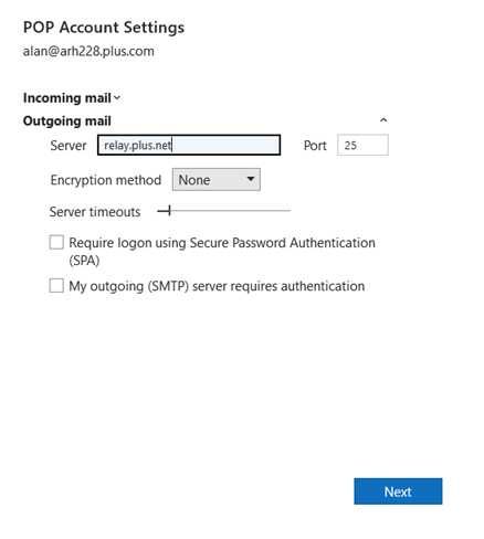

I'm also having problems sending sending emails to some gmail addresses. (see attached PDF)
I'm using Outlook 2016 for emails and have seen the 'fix' on this forum, but it's too complex for my basic IT knowledge.
Any solutions or options welcome !

@49Howarth from that attachment, it doesnt look like you are sending email via the Plusnet server (relay.plus.net).
What do you have set as the outgoing (SMTP) server in you email client ?

@49Howarth Strange, because the IP address reported in your attachment is not a Plusnet mail server. If your mail is going out via the Plusnet server then it will automatically be DKIM signed
I suggest you try changing your outgoing server settings to use port 587 and encryption method STARTTLS
You might also check the box 'my outgoing (SMTP) server requires authentication' and use the same username/password that you use for the incoming server.
Let us know if that makes a difference

Many thanks Mister W,
Those changes you suggested appear to have fixed the problem.
