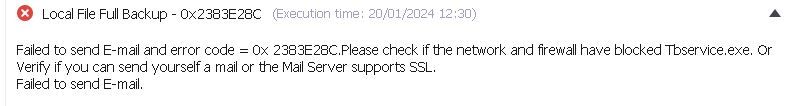

I have been trying to troubleshoot this all morning.
I wasn't getting anywhere so I decided to uninstall the Version 2024 of EaseUs ToDo Backup and put on the 2022 version. I found that the email notifications worked! However, other aspects of the program would not, such as verifying a backup image.
I put back on the 2024 version and I have the notification problem back again as well as the image verification issue, which might have been a recent problem that I have also had without me knowing. This is what I get in the EaseUs logs.

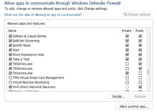

I checked Windows Defender for the Tbservice and this is what I see. I have tried unticking the two Tbservice.exe which are using the public network because I'm on a private network. Still no joy. I wonder whether I should try removing the two altogether and just leave one in place.
Next, I put on the 2023 version which I have already had on the Win 11 PC in the past and again, I have both problems.
I got an email back from EaseUs ToDo to say they have forwarded the report I generated from the program to their tech  team. I'm thinking if they still can't come up with something then I'll have to get up early and try their Live Chat.

The error code reported by the back up software is not to be found on the internet, suggesting that it is very specific to the product. The error description references SSL - to me that provokes the question of what do they mean by “SSL”? SMTP on port 587 uses STARTTLS, whereas the deprecated port 465 uses SSL/TLS which is not the same.
Have you tried to get the back up email messaging working without “SSL”?
If it works without, try port 465 with.

Thanks for your message. I have tried all configurations of email ports with and without the tick without success using the Plusnet servers. I'm currently back using the 2024 version of the program. It is so strange because it was previously working with both 2023 and 2024 beforehand. I never had the 2022 version on my PC before I troubleshooted.
Just checked again to see if I can use the Gmail mail servers which I can. If all else fails then I can go on with this as a workaround.
However, and this is a biggie, I now see the program is playing up in so many different ways.
  • I have discovered that I cannot verify a backup image.
  • Email not working on the Plusnet server.
  • Had an error saying 'PIPE failed to transmit data'.
  • Then a backup failed with the error 'Invalid data' which their website suggests 'Long destination path, the path you set is out of system limitation, please specify a short path and try again.' BTW, this path is not especially long and I've been backing up with longer paths before. And in any case, similar backups went through OK after this.

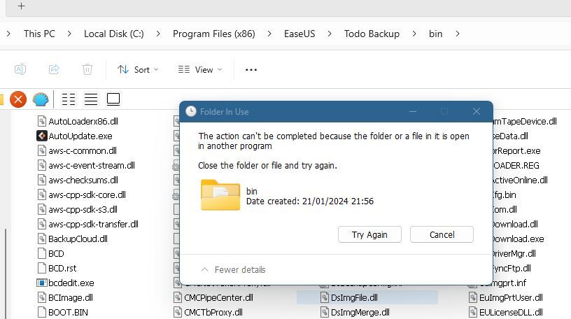

So this is where I'm at now. EaseUs sent me a file called Email.dll overnight and told me to place it into one of the program folders. However, I'm now coming up against an issue even trying to do this.
After following all the advice on this webpage (https://www.easeus.com/computer-instruction/action-cant-be-completed-because-file-open.html) I cannot overcome this.

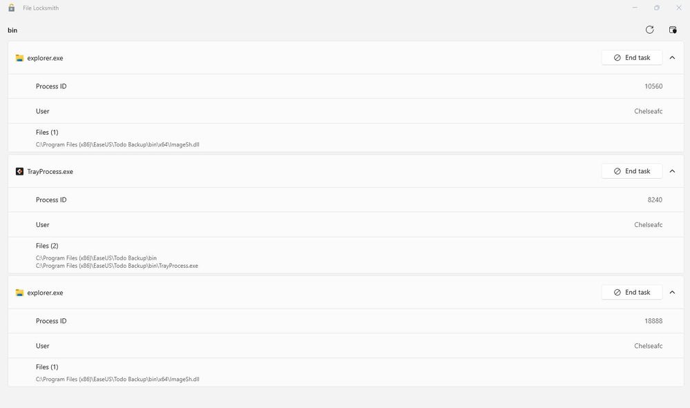

This is what File Locksmith shows me. I'm able to end the tasks and TrayProcess.exe which is to do with the backup program stays shut but the other processes come right back even after restarting Explorer in Task Manager.
So I can't even implement their suggested fix it seems.

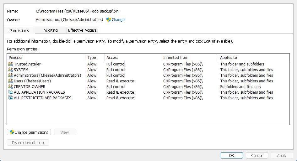

You need to check to see if this is a folder access or lock issue or a file lock issue.
Can you create a new file in that folder?  Just right click, select new and create a .txt file.
If that is successful, then the file you are trying to replace must be locked by the application (or some hidden bit of it).  You will need to stop the application in its entirety - you might need to use task manager to kill it off.  If you cannot kill it off, you'll need to do a restart and then replace the file.
EDIT PS: Have you used the Power Toys File Locksmith tool?  Install Power Toys, then in File Explorer SHIFT+Right-Click on the file name.
If you cannot create a new file, then the issue is at the folder level - access permissions might need review.
Try renaming existing email.dll, I.E email.dll.old, then add new file.

@Champnet thanks for the tip. It worked. Funny thing is I had actually saved the original Email.dll file elsewhere and called it old just in case I needed it again but I'd left the original in the folder. Renaming it allowed me to put the replacement in there.
Sadly the email notification issue wasn't fixed with this new file though. Groan!

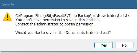

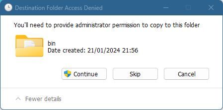

@Townman I created a new folder inside the bin folder but was not able to save a .txt test file into it. Instead this is what I got.
Here's the permissions screen for the main bin folder.
I believe I'm logged in as the Administrator called Chelsea. Is it usual to get this message? This came up before I tried to save that Email.dll into the bin folder before the rename above. Pressing Continue allowed me to move to the next step although it then failed of course. Does this indicate that I'm logged in as the Administrator?
EaseUs never told me I'd have to jump through these hoops to get the dll file into the folder so I'm wondering whether a permissions problem is still the culprit.
EDIT: I misread your instructions @Townman and created a folder within the bin folder. I have managed to paste a test .txt file into the bin folder and deleted it too.

Yes I downloaded Power Toys File Locksmith and posted a screenshot above.
