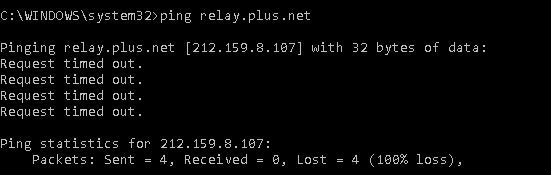

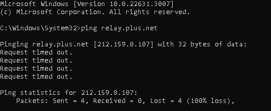

Re: Can't send email using relay.plus.net
@Townman
I take it this is how I ping. Here's the result...
C:\WINDOWS\system32>ping relay.plus.net
Pinging relay.plus.net [212.159.8.107] with 32 bytes of data:
Request timed out.
Request timed out.
Request timed out.
Request timed out.
Ping statistics for 212.159.8.107:
    Packets: Sent = 4, Received = 0, Lost = 4 (100% loss),
I have just tried again to run the SMTP diagnostic on both my new Windows 11 PC (the problem machine) and also my old Windows 10 PC. It's very strange but now both are giving ...

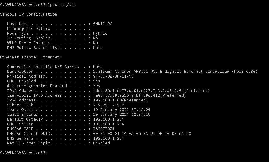

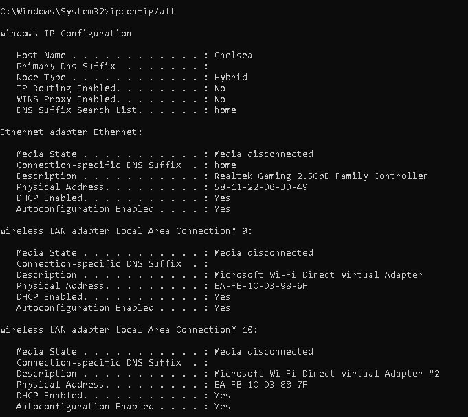

Annie
Posts: 430
Thanks: 25
Fixes: 2
Registered: ‎25-09-2007
@Townman
The router is a Plusnet Hub Two.
I hope I have understood your your requests for information. If not, please say - I am a complete novice, I'm afraid.
This is the new Windows (problematic) PC.
I couldn't screenshot in one go so here's the beginning part.
Second part.
This is the Windows 10 PC.

I can confirm that pinging relay.plus.net is the same whether the backup software is running or closed down and the program exited.
