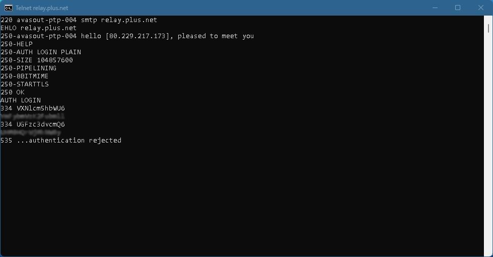

I managed to go through the Telnet steps in the end and got
535 ...authentication rejected
It gives no further explanation than this.

That would imply that the username and/or password used for authentication is not correct.
There are two combinations of username/password that can be used
1) The main Plusnet account name and the password used to login to the member centre
2) accountname+mailboxname and the mailbox password
There doesn't appear to be a specific reason for the error.

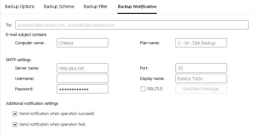

This is where I enter the email settings in the program. Note, I've removed my email address and username for privacy reasons only. They are usually filled in. I have tried using port 587 and ticked and unticked the SSL/TLS box using both port 25 and 587 and no configuration is working.

Looking back at my own notes, that “unqualified” rejection is a simple wrong username and password combination condition. I have a vague recollection that some of the special characters when used in passwords can cause issues in some environments. Back when I worked in IT £/#/$ were not always handled consistently. I am grasping at straws here!
The username should be accountname or accountname+mailboxname not email address.
SMTP should be on port 587 with encryption STARTTLS (not SSL/TLS). Some applications might treat “use SSL/TLS” as generic “use encryption” and try all options (iPhones do that), whilst others will treat it literally applying only SSL/TLS.
Get this working without encryption (review your password’s special characters) first. Then tick the SSL/TLS option. If that then fails, switch to the (not recommended) deprecated port 465 with SSL/TLS.
First step is to get the diagnostic test to work without issue. When logging into webmail - are you typing in the password or are you using the browser’s “memory”? We’re clutching at straws here … are you 100% certain that the typed credentials are correct? I’ve done it myself - forgotten that the password has been changed and then forgotten it when I’ve needed to type it. If you are using the browser!s memory you can retrieve the password from it’s security store.
