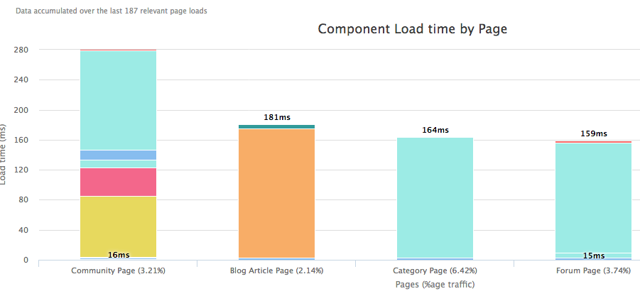

Looks a lot quicker according to the graphs

I note that the homepage hasn't sped up all that much but other pages have reduced by about 80ms

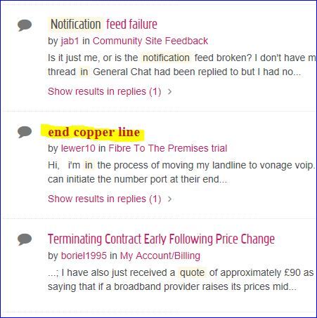

Just noticed that UNREAD items in search results display with the wrong font.
Is this related to the font changing during the load process issue, or is this just a case of an error in the CSS class?
<span class="lia-message-unread">

I shall take a look at this today as part of my investigation into the profile stats stuff. I beleive the same happens on unread sent items in private messages. Will fix this asap.

Okay so the font issue, as far as I can tell, is directly linked to the GDPR banner that pops up. This is because the same font is used and served from www.plus.net and is subsequently blocked due to the CORS policy not allowing other domains to use that font from the plus.net domain. Now... I have added some fallback fonts as the CSS was asking for the plusnet font and when it didn't render, it would display the ugly Times New Roman style font which is a default font when no other is available. I have added Arial and Sans-serif as a fallback and this has kicked the CSS into rendering the font hosted on the community properly.
I have checked the sent messages and also the search page - this seems to have fixed the font issue. You may need to perform a hard refresh to get the new CSS but it should be okay now? If anything, if the font fails to load you will at least get a screen friendly font. Screenshot below of search results.
