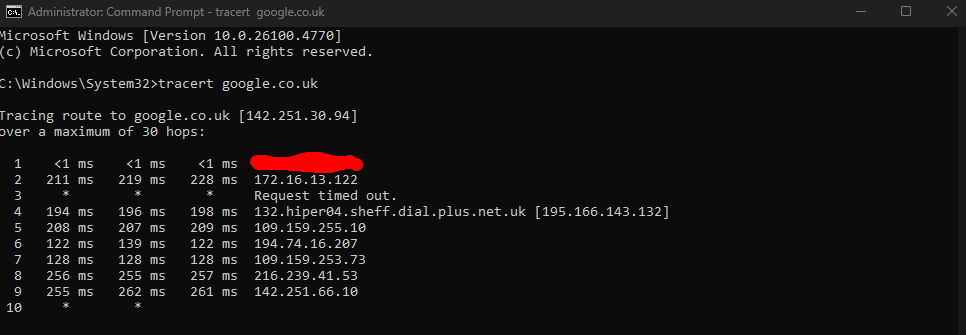

this shows what my ping isthis shows what my ping isthis only started about 2 3 days ago but my ping has been at like 250 to 300ms and ive been playing counter strike 2 and dead by daylight and its the same and i cant even walk properly im teleporting everywhere and ive done this thing on cmd and i typed tracert google.co.uk and it was saying my ping was 1ms on my router but then as soon as it connects to anything else it spikes to 170ms to 290ms

@Corey1 wrote:
tracert ... was saying my ping was 1ms on my router but then as soon as it connects to anything else it spikes to 170ms to 290ms
That does look like a local issue with your broadband connection, your router being overloaded with excessive traffic, although there could be some issue with your first hop to Plusnet gateway 172.16.32.122  however if there was a gateway problem then others would be similarly complaining.
