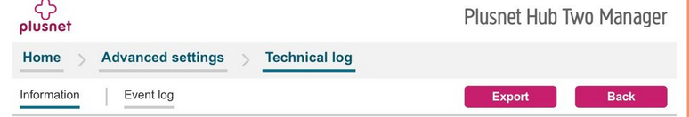

If you're doing that, perhaps post here a screen shot of your router's line stats,
for what it looks like today, and again after 10 days of DLM settling time.
I believe the screen you are looking for has this header -
