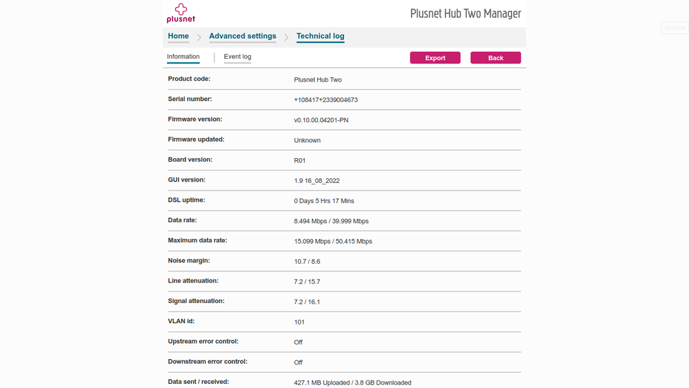

The data rate quoted in my router stats is 8.494 / 39.999
Can you also post here your router stats for -
        "Maximum data rate:
and
        "Noise Margin:"
alicelight80
Posts: 36
Thanks: 11
Registered: ‎05-04-2024
Re: Wrong line profile
Maximum data rate: 15.099 / 50.358
Noise margin 8.6

@Anonymous thanks for the question - although the 39.999 figure seems a little 'suspect'?

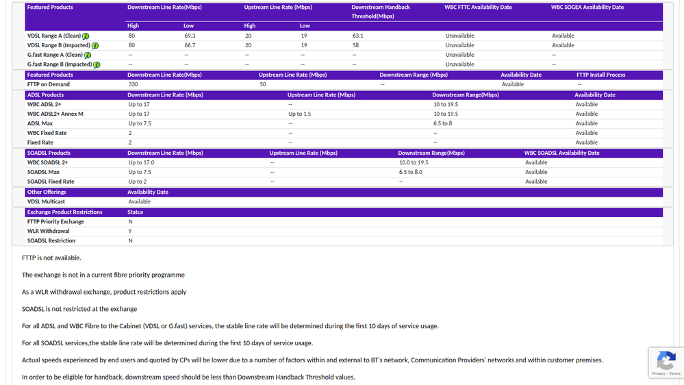

@alicelight80 I suspect there is a fault on the Openreach infrastructure. Is it possible to post a screenshot from this link, obscuring your address? BT Broadband - Address

I'm not sure I can post pictures on here as a new user? But I looked at those stats earlier and it's giving, for my specific address, stats that seem the same as Plusnet promised.
Max 80 VDSL, downstream handback threshold 58mbps on impacted, 63.1 on clean

Yes you can post pictures. Assuming you are using a desktop/laptop, take the screenshot, obscure your details, and the click the 'mountain' icon to the right of the 'smiley face', and follow the prompts - it is much easier for us to work from a full picture of the situation.

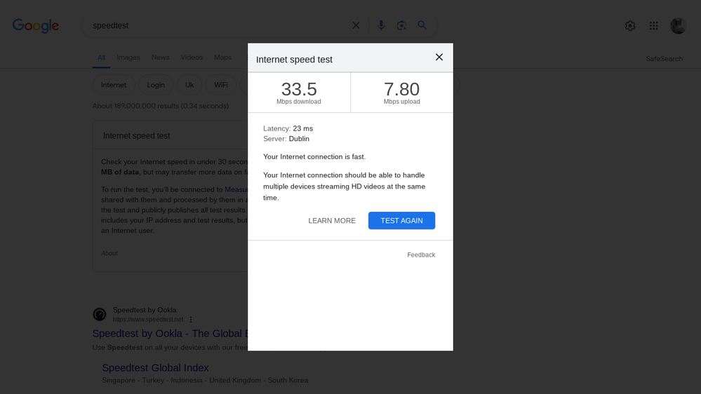

Whilst I'm at it...
Screenshot 2024-04-05 20.46.52.pngScreenshot 2024-04-05 20.46.52.pngScreenshot 2024-04-05 20.46.11.pngScreenshot 2024-04-05 20.46.11.png

Thanks for that, @alicelight80 . You clearly have a line fault, from previous information and that data. Unfortunately , it is now the weekend, so response times from PN will be extended, but I suggest as a first step that you report a broadband issue via this link:https://www.plus.net/help/report-a-problem/ . You probably won't get a response until tomorrow, but whenever you do, let us know what it is, please.
