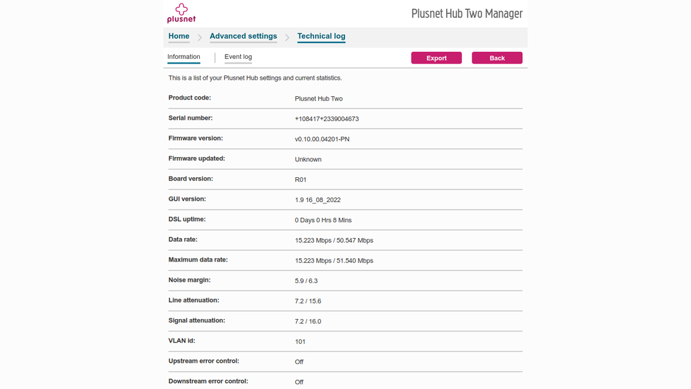

@MatthewWheeler given that the DLM reset didn't restore @alicelight80 's speeds,
can you check that @alicelight80 has been provisioned on 80/20 SoGEA. and not 40/10 ?
as it looks unusual that their router download "Data Rate:" is exactly at 40Mbps,
given that the corresponding "Maximum Data Rate:" is quite a bit higher !

Just noticed router dropped connection and re-connected higher, particularly upload, though download still below the handback threshold of 57mpbs on this 80 line - wonder if it'll improve or regress... (previously was stable at max 35 down, 7.5 up, data rate profile was 40 down, now 50)

Oh the noise margin has changed too
Re: Wrong line profile
06-04-2024 8:38 PM
That is looking much better, @alicelight80 . Noise margin back where it should be - roughly - and speeds creeping up, although you might get a couple more 'blips' as your speed (hopefully) gets above the H/B threshold.
