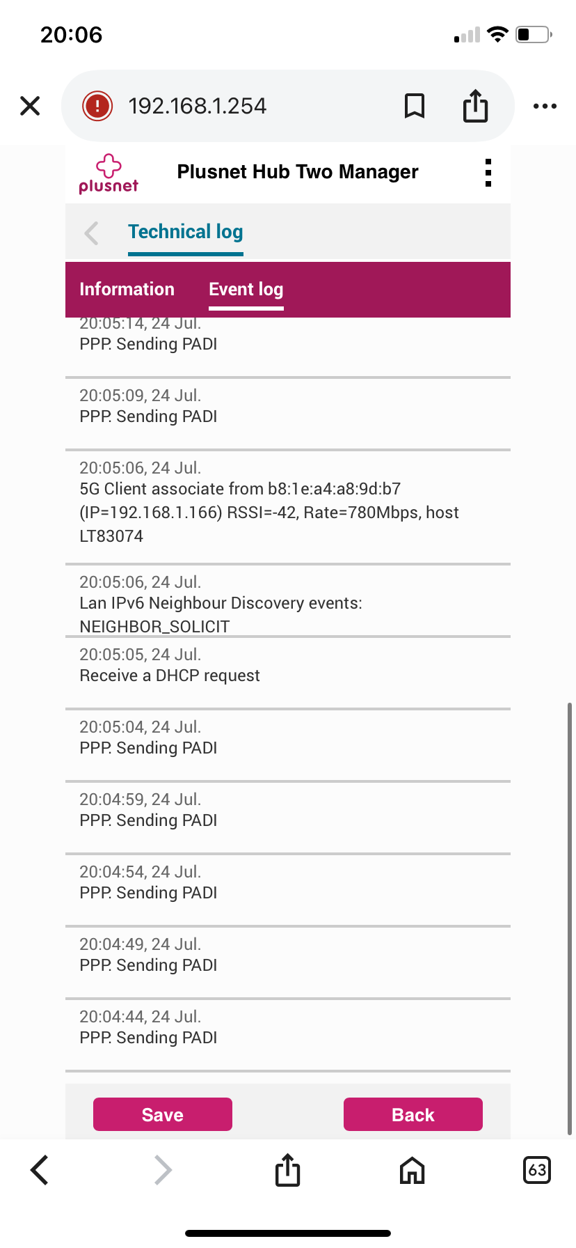

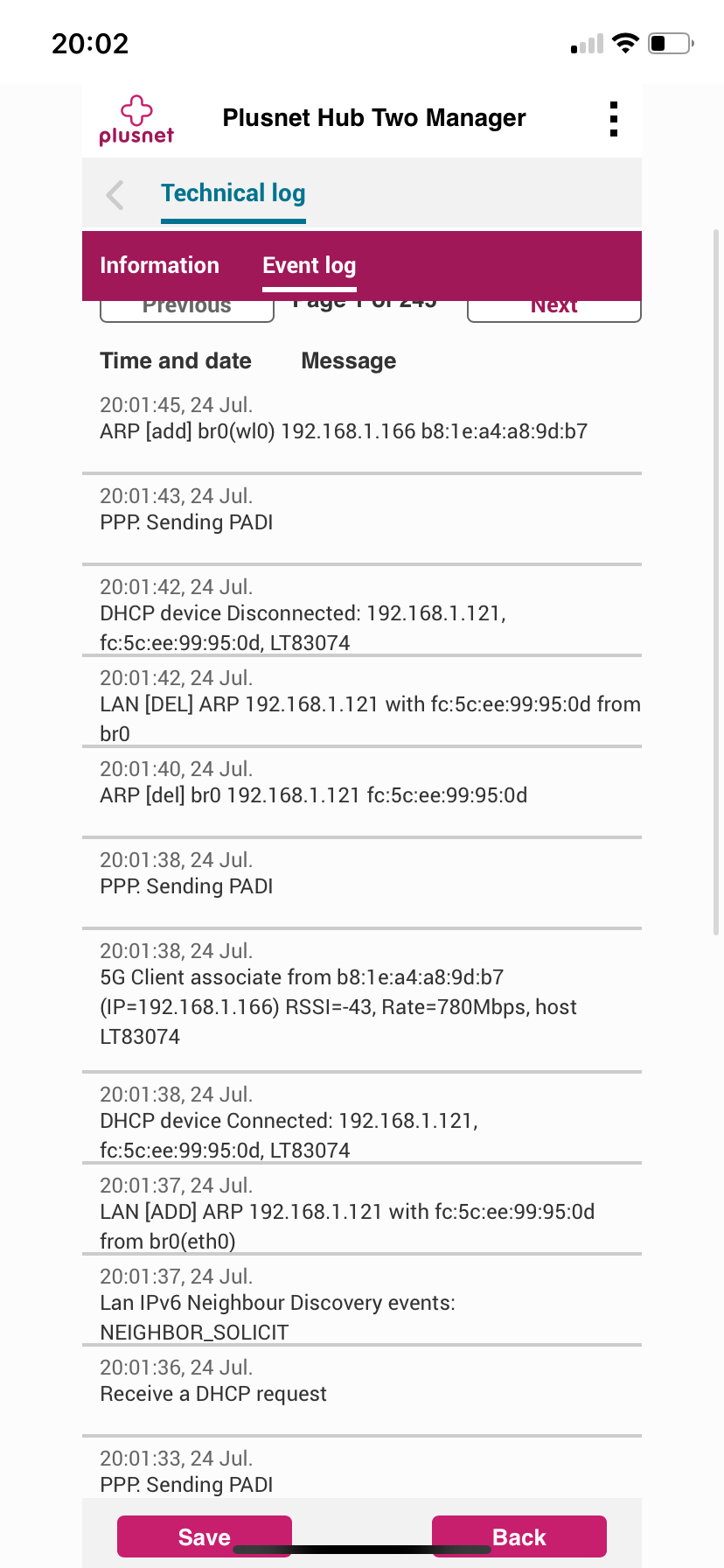

Oddly I’ve just tried with my Ethernet cable and my laptop wouldn’t connect to the internet full stop. I’ve just taken the cable out and attempted to connect back to the wifi and after a good while, I’ve got a connection and VPN connected.
I’ve taken screenshots of the event log on my phone, but can’t for the life of me work out how to attach them!

looking at the log extracts I see repeated "PPP Sending PADI" messages
That message usually appears when the Hub is attempting to initialise a PPPoE session but is not getting a response.
Did you notice the Hub light was solid Orange at this time, on the ONT were all lights green?
Had you powered off the Hub for any reason around the time you took log images?
Other than your work laptop and smartphone what other devices do you use?

Hi,
The light on the Hub remained blue. Apologies, what is ONT? No I hadn’t done anything with the router.
Other than my work laptop and smartphone, there’d be my work phone and my personal laptop, my husband personal phone, work laptop and work phone. We’ve got an internet hub for our cat flap, Sky and a PlayStation.

Is your personal laptop able to connect to the Hub? If so you could use that device to export the Hub's event log as a CSV file and attach to a post?
The importance of the event log in a CSV format will give a fuller picture of the Hub activities since it was first turned on or a factory reset was performed, there is no personal information in the log.
The log will help identify if devices are struggling to maintain a WiFi connection which could be significant for your issue.
From the Hubs home page navigate >Advanced Settings >Technical log >Event log select Export
The event log is exported to the Downloads folder as a CSV file, use the paper clip below the reply window to attach to a post.
That doesn't make sense😕

As an experiment I connected a switch to the Hub Two WAN port, the light does solid Orange and the Hub makes "PPP Sending PADI" requests.
Not having a DSL connection anymore I can't say what would happen if there is an active VDSL connection, Any thoughts?
