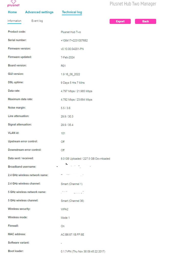

Which router are you using? There is obviously a fault, but knowing the answer to my question helps in replying.
If the phone test passes, report a broadband problem via: https://www.plus.net/help/report-a-problem/broadband/
The above assumes you still have 'normal' landline connection - if you have a SOGEA (internet only) one the only option is to call Plusnet - 0330 123 9123

OK. In that case please follow the below.
BTW Performance Tester - Over a wired (Ethernet) connection if at all possible, please report the 'ADDITIONAL DIAGNOSTICS'- if it will run. This test is recommended to be performed with only one device connected.
For the Hub One -
For the Hub Two -

Taking the status page into account with the BT Availability checker, you are below the Hand Back threshold and your SNR is too low. Call support and ask them to run tests.

@Povvercrazy I have tested the line and there is an external fault for you. I have raised it to OR and it should be fixed in the next few days.
