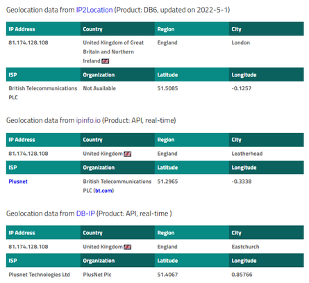

Posts: 5,005
Thanks: 3,315
Re: Static IP?
@Townman
I think the issue here is the term being used, I believe like you the "IP Address" is static but the geolocation "address of the IP" is coming up with different locations and this is where the misunderstanding is.
@Kali_ffs
Using https://www.iplocation.net/ip-lookup for IP Address  81.174.128.108 (not my IP address) you see many locations (see snap below), this site also indicates the geolocation database being used.
This does not mean your public IP Address is connecting at a different location to where you actually live.
Dan.
