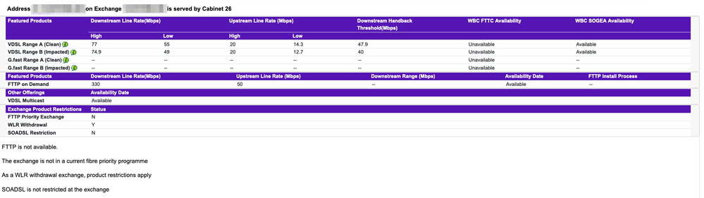

Sorry to ask for more information, but can you post a screenshot of the result from: https://www.broadbandchecker.btwholesale.com/#/ADSL , or https://www.broadbandchecker.btwholesale.com/#/ADSL/AddressHome - remove your personal details before posting?

Here we go!
Posts: 17,670
Thanks: 8,991
Fixes: 383
Re: Speed slowly dropping
I take it from that that you are on a SoGEA (no phone) connection? Given your BTW speedtest result of 48Mb/s, I would suggest calling PN Support and reporting a fault, as you are at the handback threshold.

I'm not familiar with SoGEA, but from what I'm reading (https://www.plus.net/broadband/discover/what-is-sogea/) it's "Fibre broadband without a landline". However, I do have a traditional lineline - there's a Master socket with a BT jack that I could plug a standard landline phone into, although there's no landline plugged in any more, and this also has the router plugged into it. FTTP isn't available in my street yet.
Even with this is mind, would it be advisable to raise this with Support?
Posts: 17,670
Thanks: 8,991
Fixes: 383
OK - it was the fact you used the address version that made me assume you were on SoGEA. I would still contact support, but given that your router is reporting a connection speed above the 'impacted' minimum rate, they will probably say they are satisfied with your connection speed and there is nothing they can do.
