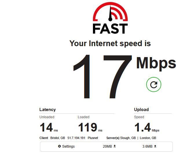

Happy to answer questions. From my perspective - nothing has changed in the house set up from when we were on Sky so I'm surprised to have the issues we've been having. Latest speed test after rebooting the router:

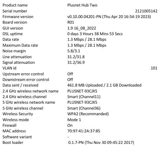

@jab1 had to reset the admin password as I'd forgotten it!
Posts: 25,556
Thanks: 9,291
Fixes: 392
Re: Speed Issues
@IJJ As your speed is way below the hand-back threshold and your connection is flaky, I suggest you use the link I provided earlier to report a fault. Let us know the response, please.

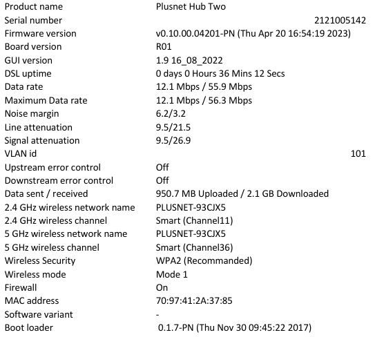

Can you please post the latest Technical Log page please?

@Marsh
I would say there is a line fault somewhere as since your test the Line attenuation has gone from 31.2/31.8 to 9.5/21.5 which suggests @IJJ house is now nearer the green cabinet.
I would suggest NOT restarting the Hub for now.
