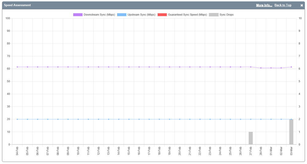

@adam945  I found a screen grab with the faster H1 sync speed from May last year.

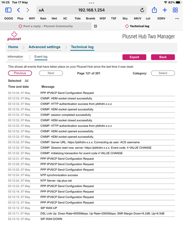

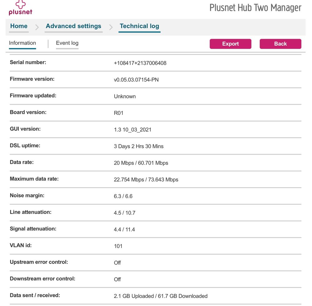

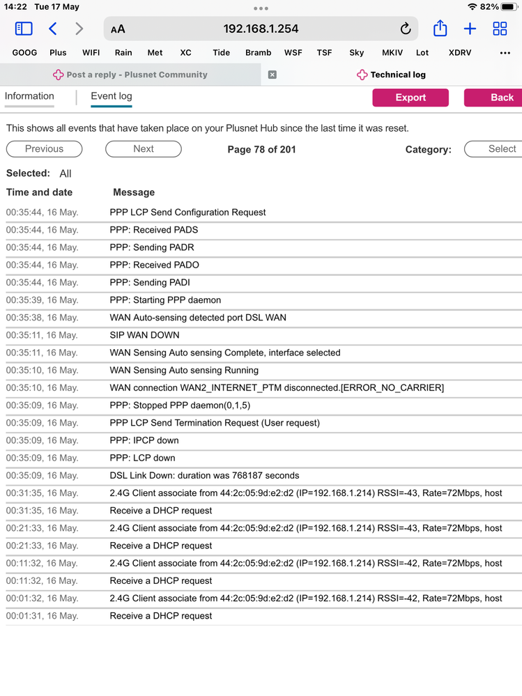

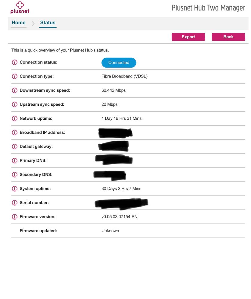

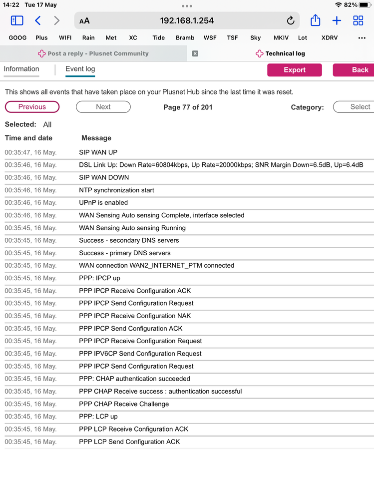

It did jump up last week to sync just under 66Mbps but has now dropped back to 60Mbps. @adam945 can you see any reason for that jump up to 66 then back down 60? Cheers
Screen FFF7B27A-1471-42D4-95A7-ED36823F1316.png137E1370-0068-443A-83E7-A2A34A3A4B80.pngF5E4B3F2-2CCC-47A2-B641-8B794AE01243.pngsnips from the logs.
