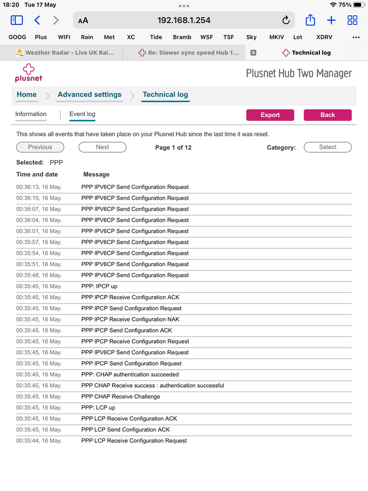

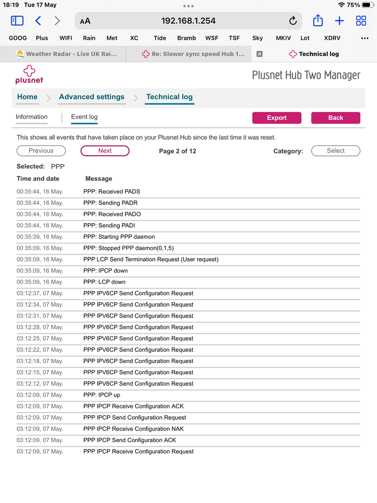

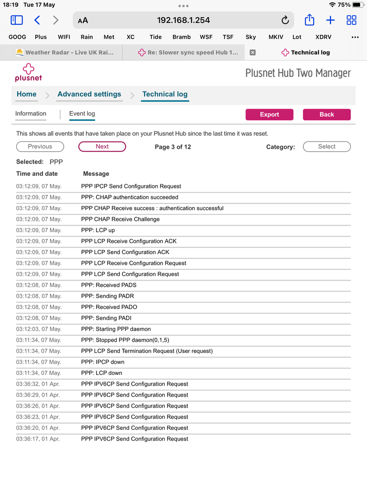

@LaurenB If I read those logs correctly, the OP is getting PPP drops, which could explain the speed reductions, if DLM is feeling aggressive.
Re: Slower sync speed Hub 1 vs Hub 2
17-05-2022 6:23 PM
Here are the filtered PPP logs, not sure if it gives any clues. It seems to have held the 65mbps sync for 9 days before dropping down again.

The only thing that stands out in those extracts is that you are still getting PPP drops, for some reason, but they are lacking in detail as they do not contain the connection speed and SNRM figures on reconnection. I'm also mystified why you appear to be connected on IPV6 when PN do not offer it, but that could be a red-herring.
That's because Category "PPP" has been selected, you need to select Category "WAN", you should see something like
