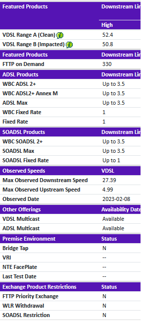

Heres my line stats . Says on there the max observed speed is 27mbit from today ( Which i dont believe is correct ) ALso states my upload speed has been observed at 5mbit, which to be honest i seem to be getting slightly higher.
willcutforth
Posts: 1,718
Thanks: 80
Fixes: 113
Registered: ‎27-11-2020
Re: Slow Speed DLM Line Reset
Hey there @mrluke just done a DLM reset now for you to see if it helps. I couldn't see what it was showing at from our side so I just reset it to 6dB.

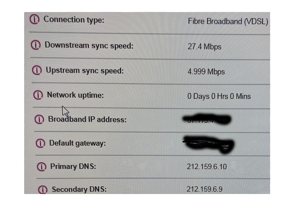

Seems im getting the exact minimum download speed as stated by plusnet ? Has this been capped ?
It states in my broadband speed email
Minimum Guaranteed Speed: 27.4Mb
But states also peak download rates
Download: 31 - 45Mb
how am i able to get this if im capped at 27.4 ?
