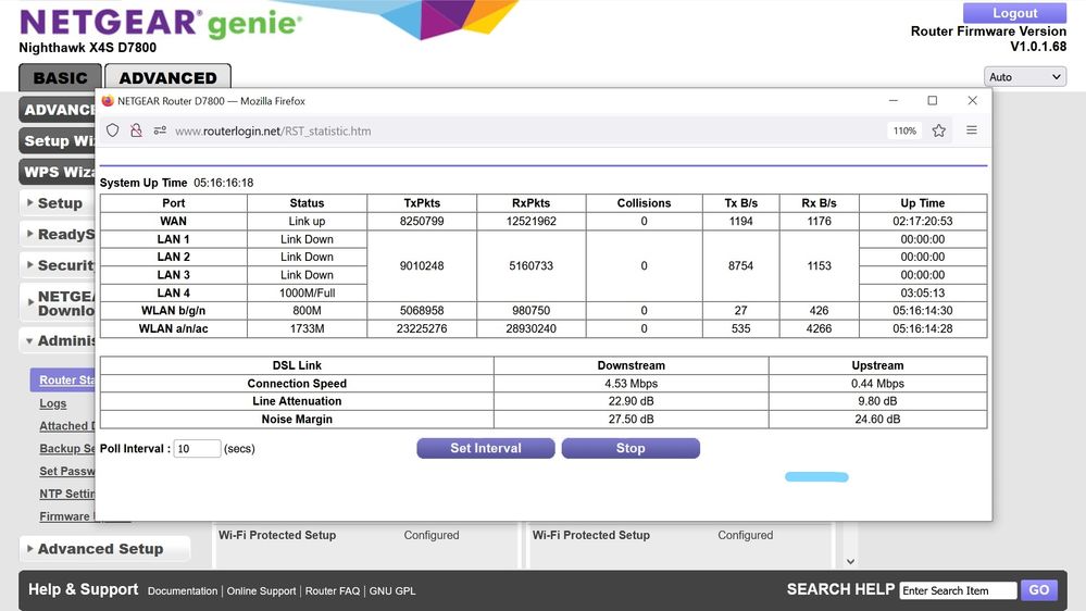

Hi all,
          About a week ago I noticed a large drop off in the speed of my Plusnet ADSL broadband, it has dropped to roughly a third of the speed I had been getting previously. This means it's taking ages to download anything from Xbox Live, Netflix is buffering a bit & I'm not able to see the best quality HD versions of things I'm watching. I've taken a screengrab from my router statisitics (Netgear DG7800) - see below). The speed currently has been showing 4.53Mbps downstream consistently for roughly a week, it had previously nearer 12Mbps before slowing down to it's current 4.53Mbps.
Could somebody from Plusnet be able to look into this?

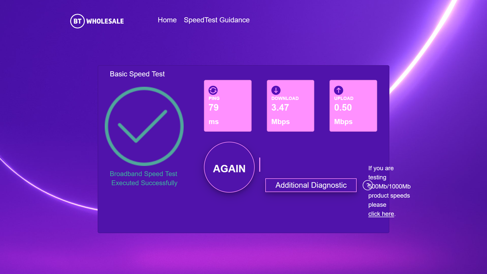

OK - it will probably need Help Team intervention, but if you complete the steps below it may help others to help you.
For Community members to be able to help, information from these two sites, as screenshots:-
BT Broadband(obscuring your phone number) and BTW Performance Tester - Over a wired (ethernet) connection, please report the 'ADDITIONAL DIAGNOSTICS', and sight of the HELP DESK tab from your Hub would be a start.

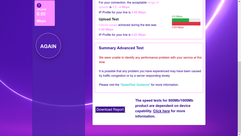

Thanks for your assistance, @jab1 ! I'll post screenshots from the sites you've said in the hope that someone from the Plusnet team can assist further.
I have to admit I don't know what "sight of the HELP DESK tab from your Hub" means. A BT hub perhaps? I've never owned let alone used a BT / Plusnet hub as I've always used my own Netgear routers, currently a Netgear DG7800.
BT Screenshot 1.jpgbt screenshot 2.jpgScreenshot 2022-03-08 16.16.25.pngScreenshot 2022-03-08 16.18.08.pngScreenshot 2022-03-08 16.18.16.png

You have WBC FTTP showing on the results which means you can get Ultrafast broadband if you so wish. Unfortunately PlusNet don't current offer a FTTP product though it is supposed to be coming later this year.
If you want it now you can move to BT or EE FTTP free of any contract termination charges so long as you talk to PlusNet first.

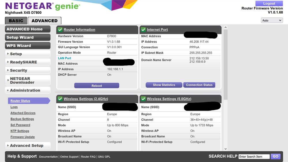

@jab1  I hope these two additional screenshots from my Netgear Router are also helpfulrouter 1.jpgrouter2.jpg

@Kikusui They are useful 😀 I would suggest you Report a fault at: https://faults.plus.net

Hi there,
I'm really sorry to see you're  having speed issues.
I can see you've had some drops last week that seems to have caused your speed to be automatically capped on to the 2mbps to 4mbps profile. I've tested your line and the tests are showing a high resistance fault, which this is likely the underlying issue so before resetting your line, I'd like to arrange an engineer with you to investigate further.
Could you reply to the ticket I've logged on your account Here with when you'll be available for a visit? If you can post back once you've responded, I'll make sure we book the engineer as soon as we can.
