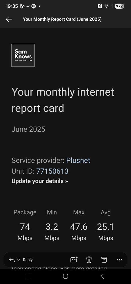

Hi, good evening! 🌙 Regarding your download speed and other stats, do you have SamKnow Whitebox 8.0? That will give you all the information about your download speed, upload speed, DNS response speed, and hub speed as well! 🚀💻 #SamKnow #Whitebox #Download #Upload #DNS #Hub #Speed #Information

I thought SamKnow Whitebox program had ended?

simonc2
Posts: 114
Thanks: 18
Registered: ‎14-11-2007
Re: RouterStatsHub and plusnet Hub Two
@DJMcKenzie87
This post
Sam-Knows-closure-repurposing-white-boxes
seems to suggest Sam Knows Whitebox is no longer available.
DJMcKenzie87
Posts: 54
Thanks: 14
Registered: ‎12-07-2024
Its stilll  working  and I can login to Dashboard see informationIts stilll working and I can login to Dashboard see information
