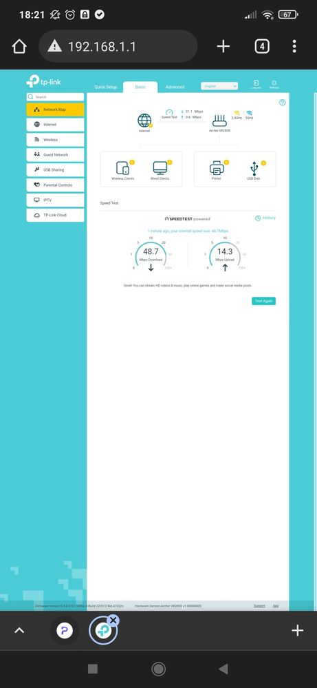

Hi all,
Just done a speed test on the router, and they are currently back at around 50Mb now.
Will monitor to see if this is stable, but fingers crossed. Thanks
Posts: 27,077
Thanks: 11,167
Fixes: 1,649
Registered: ‎21-04-2017
Re: Reduced speed profile set for my account (again)?
Awesome that's good to see @OhWell and thanks for the update.
Fingers crossed all is well but let me know if you have any further issues Smiley

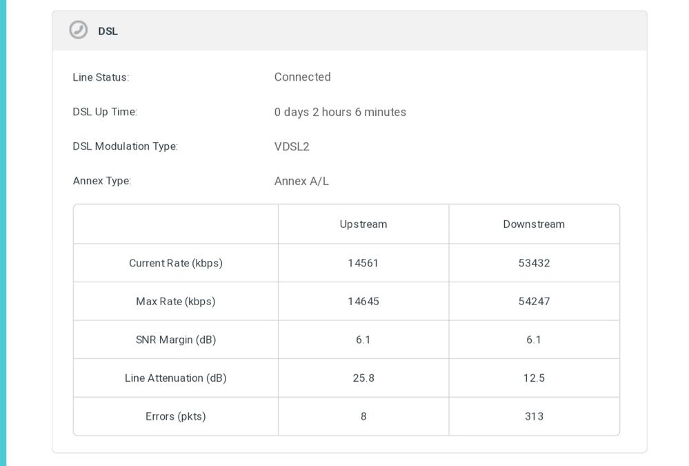

Mustrum
Posts: 3,703
Thanks: 1,104
Fixes: 81
Registered: ‎13-08-2015
@OhWell   any chance you could post details/pic of the DSL settings from the Advances status page as a comparison from earlier.
OhWell
Posts: 86
Thanks: 6
Registered: ‎13-08-2019
