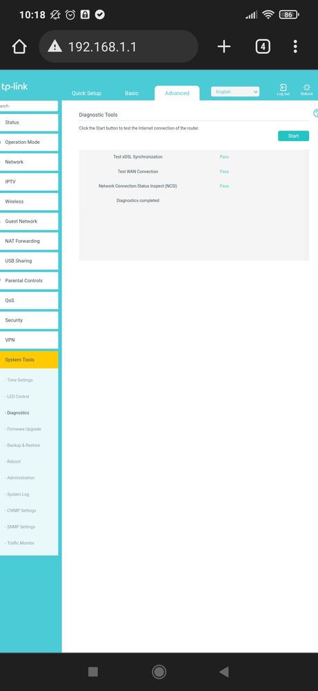

The router has system logs on it, although no critical alerts just usual dns request etc.  The router is a tp-link one which has caused no issues previously. I would check with the hub one, but it is packed away and not easy to get to.
Also has a diagnostic check feature that says the line is ok.

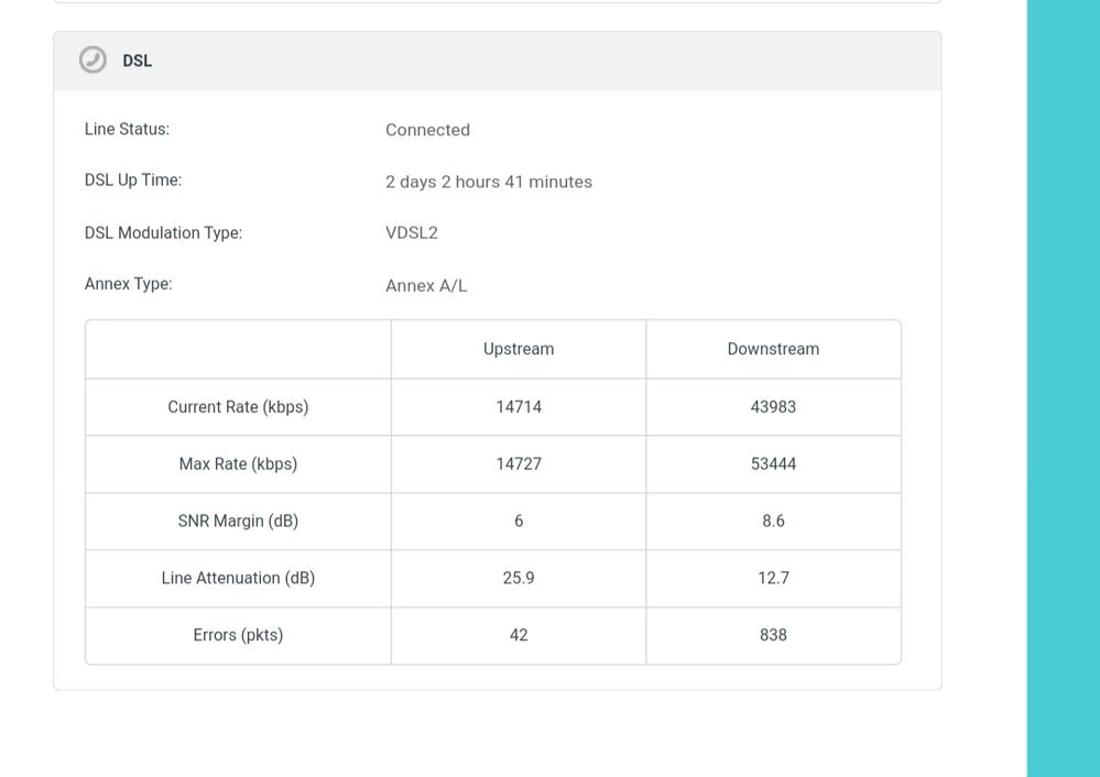

@OhWell   on your TP Link if you go to the advanced section tap on the right-hand window then scroll down to the DSL status and post that, i.e. my example below.
The DSL checker link, and the advanced speed test @jab1  provided the links to will tell him the information about the profile you are so keen to get.

Please see below
IMG_20221025_163615.jpgIMG_20221025_163539.jpgScreenshot_2022-10-25-16-34-52-744_com.android.chrome.jpg
Posts: 22,727
Thanks: 7,935
Fixes: 334
Re: Reduced speed profile set for my account (again)?

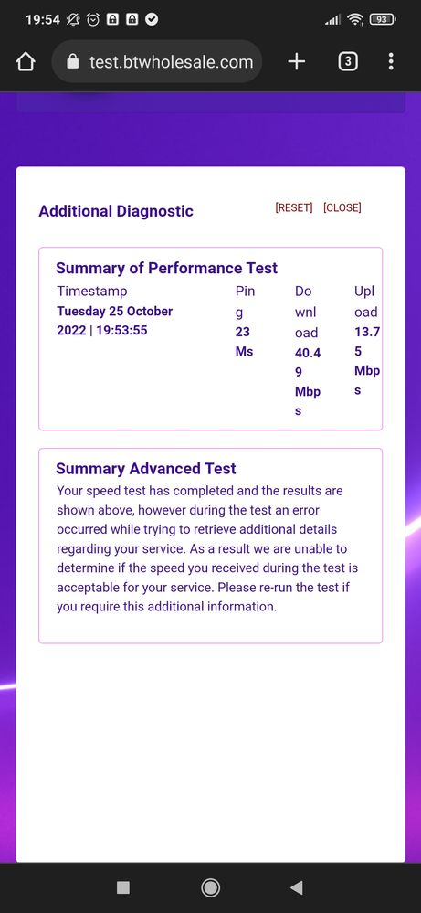

@OhWell Thanks for that information., quite a lot more useful than speed test results. Unfortunately, the BT speed test you have posted is not the one I asked for - I asked for the 'Advanced Diagnostic' which gives  a little more useful data.Also, the first report advises that the speed to your test socket - the limit of Plusnets responsibility - is 43.98Mb/s, which is below the Handback threshold for a 'clean' line, but above that for an impacted one. Having said that, it is below the expected range.
If you could supply the 'Advanced' report, this will enable me (or others) to suggest the next step.

OhWell
Posts: 86
Thanks: 6
Registered: ‎13-08-2019
Hi John,
Please see below.  I did reboot my router couple of days ago to see if that had any affect on the lower speed. However I usually leave it on all the time to avoid the line looking like there are faults and reducing the speed.

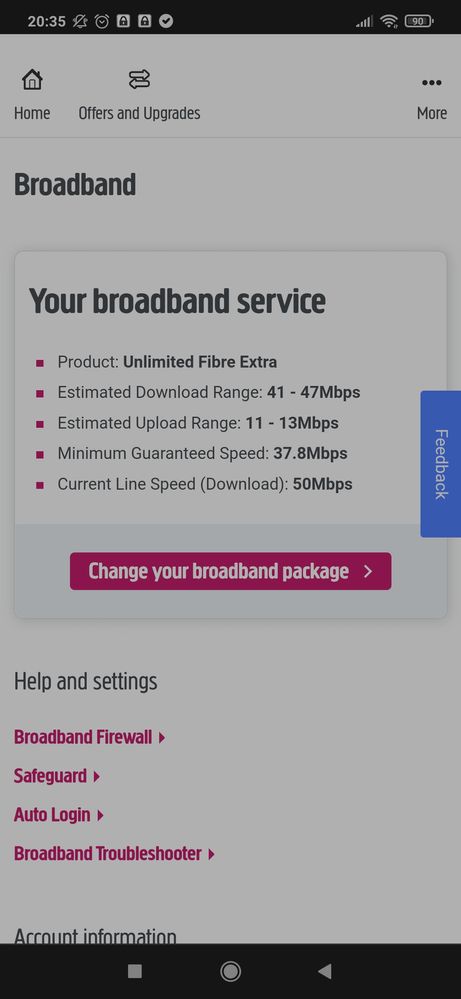

@OhWell Thanks for that, although thanks to the vagaries/deficiencies in that test, it isn't telling me what I really need to know, so I'll have to ask you to have a look on your account. Somewhere on there (and as I no longer have access to a full PN account, I can't tell you where), there should be a reference to your IP profile - any chance you could find it and report back - please?
From what I can see at the moment, from the data you have supplied, something is not right - you should certainly be getting greater speed than you are - but it is difficult to say what is causing you to be at the bottom of the range as shown in the BTW screen shot.

This was all I could find digging around my account.
I have been dropping slowly below 50Mb over her last couple of months I'd say, but it was around the 45Mb to 50Mb range which I just accepted as maybe temporary dip sue to lots of people online.
Only after the last week or so have I notice it drop to pretty much bang on 40Mb, which looked suspiciously like a speed limit being applied. Maybe that is just a coincidence though.
Thanks. Looking at that, and comparing it with the BTW screenshot - I would say something is wrong, you should be getting better than that.
The Advanced Diagnostics should run properly - give it another try tomorrow.
