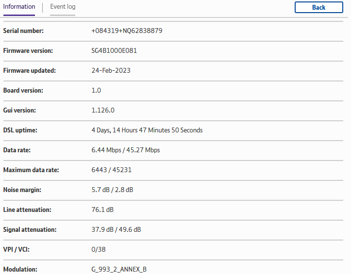

@Faizan786
Looking at your connection details there is an issue of some sort, the Line attenuation reading is extremely high for the reported Maximum data rate.
Also the slow upload speeds might cause issues during a cloud saves or similar due to router buffer bloat.

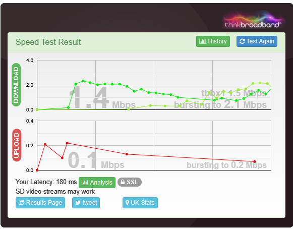

Re: Possible Hot Vlan
As @Dan_the_Van Says above, you clearly have a line/connection issue - just report it.

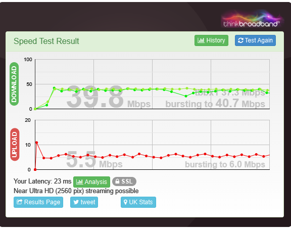

Only have issues after 6pm during the day it's perfect.
Faizan786
Posts: 261
Thanks: 51
Registered: ‎31-05-2015
During day

@Faizan786
You have included further information about your connection this time
Some thing is wrong, looking at the Hubs reported modulation says you have a ADSL connection
What product are you on?
Posts: 4,953
Thanks: 3,251
Fixes: 147
Checking again G_993_2_ANNEX_B is VDSL. but I would not expect to see VPI/VCI settings as those are usually for ADSL
True, but this IS a BT Hub!  and probably old firmware ?

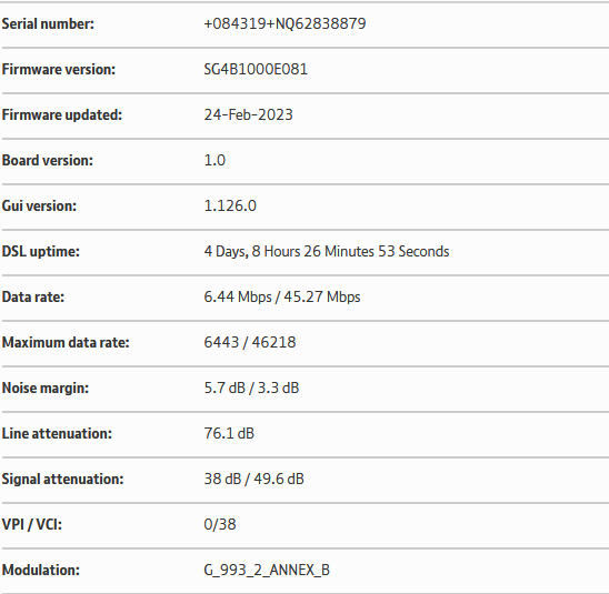

Opera Snapshot_2024-11-01_202238_192.168.1.254.pngOpera Snapshot_2024-11-01_202429_www.thinkbroadband.com.png
Right now compared to earlier.
