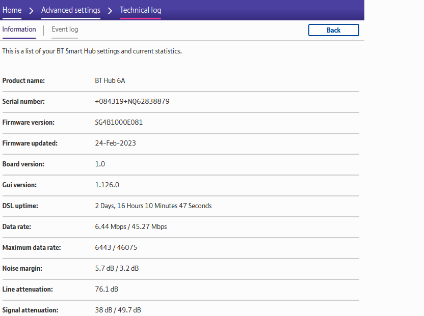

Wich version, and can you post a screen shot of you router stats please.
Faizan786
Posts: 261
Thanks: 51
Registered: ‎31-05-2015
Re: Possible Hot Vlan
Is that Home - Advanced settings - Technical Log
Information or Event log?
Posts: 25,097
Thanks: 9,052
Fixes: 385
Both, if possible. I don't know the BT Hubs, but does yours allow the full event log to be exported in .csv format?
Faizan786
Posts: 261
Thanks: 51
lost me there mate. Im a screenshot kinda guy and both info/event don't fit in one picture. Is there a specific info i can tell you that your after.

Faizan786
Posts: 261
Thanks: 51
Do data rates of around 46Mbps with such high attenuation figures look right?
Posts: 25,097
Thanks: 9,052
Fixes: 385
@Anonymous I was wondering about that too, but got distracted. I also note that DSL  uptime is low. Wondering if the OP has a fault?
