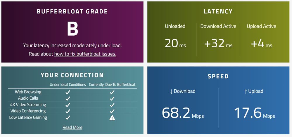

I was getting ahead of myself and having fun learning so was doing incremental rises and see what I got with each one.
I did 8 changes in all and ended up with B grade and speeds that I think are acceptable
19 - 70
19 - 75
20 - 75
20 - 80
21 - 80
21 - 85
21 - 90
21 - 88

I am happy with that last B grade which was set at 21/88
I actually enjoyed myself and had fun this evening learning all of this so thank you very much for helping and sticking with me, it is very much appreciated.

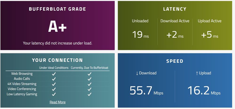

Have been playing around again, tried 20/85 and although I achieved "A" grade the speed dropped again
After doing lots of incremental changes I think I will stay with 21/88 as it is giving me the most consistent results that I am happy with.
I even got a bump up to "A" grade 😁
21 - 88
