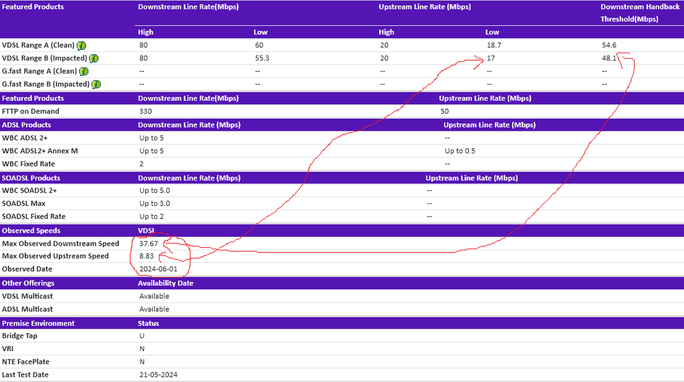

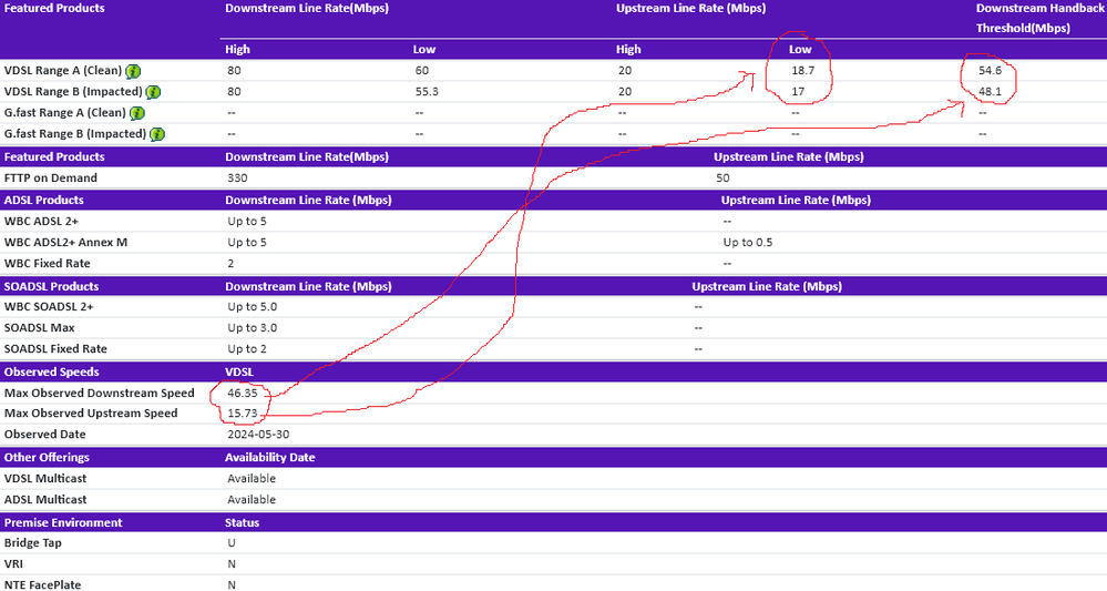

Before we on Unlimited Fibre with line rental everything was stable and get 40/10 max speed. Then Changed to Unlimited Fibre to Fibre (SoGEA 80/20) the service went unstable and intermittent all the time since May 14th. The fault is now open with Openreach engineer attend tomorrow at 8am to 1pm due to network fault. Plusnet also sending out new Plusnet Hub Two Router to replaced Plusnet Hub One.
The ticket was on hold https://www.plus.net/wizard/?p=view_question&id=241950473
The Plusnet Hub One Router sync was awful 46/15 expecting that to be 80/20 say on BTw Checker Range A 80/20.

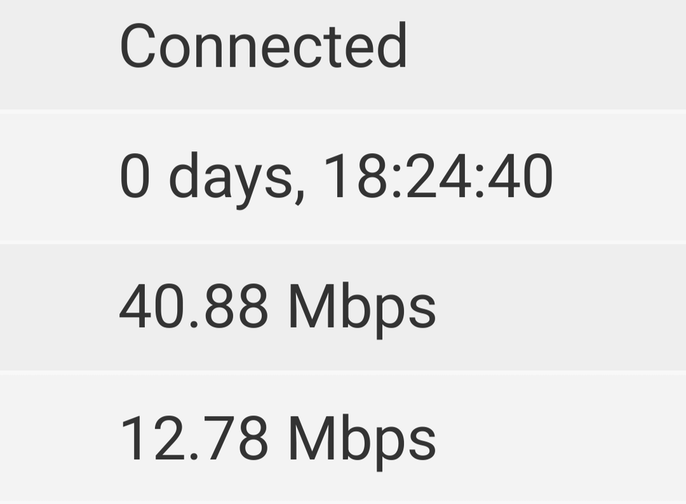

Broadband sync now reduced to 40/12 that's not good service for 80/20

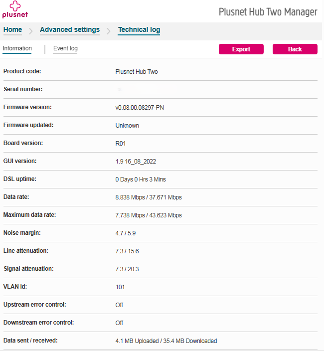

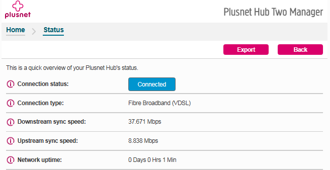

Engineer (Mike) just been this morning spend two hours try to fix outside in my local area (network issues) and came back with bad news as he spoken to the network manager as the broadband at the cabinet is too full (crosstalk) and reduced down to 37/8 as he isn't happy about it and saying it should be over 55/19 but he will come back in three weeks time try to get it fixed. Also put new Plusnet Hub Two router on it.
Not happy at all. We paying for the service 80/20 not 40/10? Are we on the correct profile 80/20?

A line attenuation of 15.6 would suggest your property is about 0.5 Km from the green cabinet. For 80/20 the green cabinet would need to be outside your property.
See https://www.increasebroadbandspeed.co.uk/chart-of-bt-fttc-vdsl2-speed-against-distance-from-the-cabi...
The state of the internal phone extension in you house can also impact the line attenuation, that is why the recommendation is to use the master socket.
Your speeds maybe impacted but I suspect the Openreach technician is correct in his findings
The BT Availability should be used with caution as it does not take into account your physical connection condition. With every contract plusnet detail the speeds of your connection and MGS (Minimum Guaranteed Speed) mostly it is this plusnet will refer to.
Edit: You may be on the wrong profile.

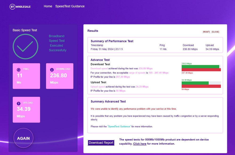

I think my parents BTw Performance Test no longer work as I just want to check her profile rate on their line. Without it can be very annoying now because I think Plusnet has now removed current line speed via this link: https://portal.plus.net/member-centre/broadband as we don't know what her current ip profile on her line? I know PN can do GEA Test to check it.
Below it off-topic as I just tested my BTw Performance Test for my own line G.fast sync 255.96Mbps with my difference ISP with BTw IP Profile showed the correct for my line speed 247.49Mbps.
Screenshot below (this is my G.fast line not my parents FTTC line)
