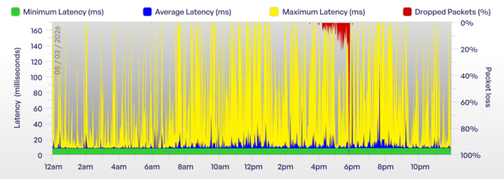

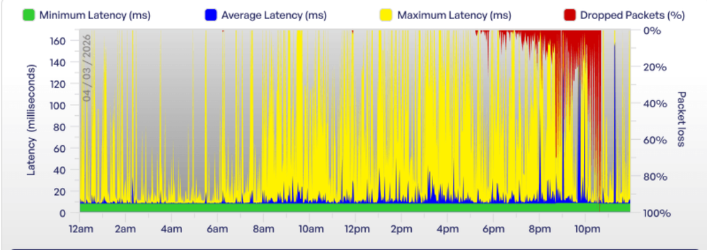

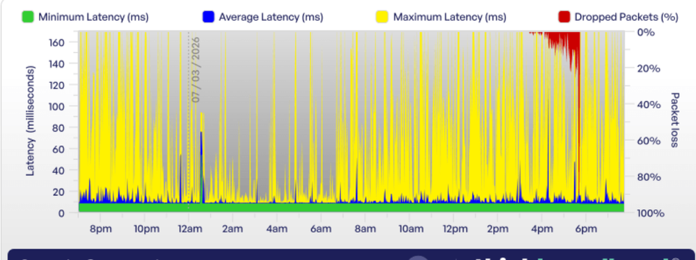

Was wondering if anyone has seen anything like this.
Connection is rock solid with no inbound or outbound errors with speeds pretty much at the limit for my line length.
Then things start getting slugging, sites timeout and my broadband monitor shows this - this is Wednesday, Thursday and today - yesterday it didn't happen
Rebooting the router doesn't fix the problem, only turning it off and leaving it off for a minute or more seems to solve it.  The router is an Archer VR600 v2 which I've had for a few years now

@SteveA Is this a recent change in behaviour? Have you possibly had a change of IP?
Not really my area of competence, but this graphs do look a little concerning - all the time, not just around the times of your major packet loss, which won't help, at all.

the latency has always been like that  - the sudden appearance of dropped packets which gets worse is something that only started recently.  Nothing has changed, been with PN for ages and ages and on a fixed IP.

I puzzle over the value of BQM because it does not tell us where the delay / loss occurs.
Local faults on FTTC & ADSL are often seen in loss of sync speed in response to changes in line loss & line noise.

I've never really taken much notice of the latency monitoring - but I do know if I do something like download an ISO image for Linux / Windows then they do spike and the blue bit gets a lot bigger. I don't find the lag a problem at all as I'm not a gamer.
But the packet loss does seem to be useful  and accurately matches the connection degradation. As BQM are pinging the router I guess it could be the router having issues but why does a reboot not fix it, only a power down.

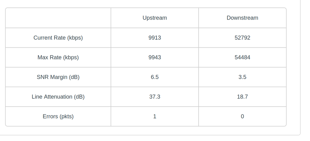

so, my wife has has her laptop powered up for a while, issue has not happened since the last time I posted about it. Line has been up for 6 days 17 hours 31 minutes and has only got a small number of errors which occurred on Thursday night when I was actually surprised the telegraph pole (which is over 100 feet away) didn't fail (given that it's rotten to the core)
  Upstream Downstream
Current Rate (kbps) 9913 52792
Max Rate (kbps) 9924 53092
SNR Margin (dB) 6.3 3.4
Line Attenuation (dB) 37.3 18.7
Errors (pkts) 27 161

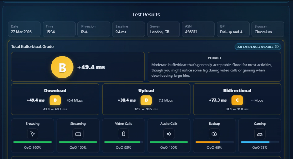

There is value in looking at QoS as your upload speed is not that fast.
If you are interested try a bufferbloat test
https://bufferbloat.libreqos.com/ or https://www.waveform.com/tools/bufferbloat
As with speed testing this should be used using a wired connection with no other device active.

I've saturated the upload and download and they do what you'd expect - the latency increases (i,e. the graph goes blue) but I don't get the packet drop. I've also pushed large amounts of data across the wifi on the router and it doesn't affect the Monitor
Bufferbloat shows this:
