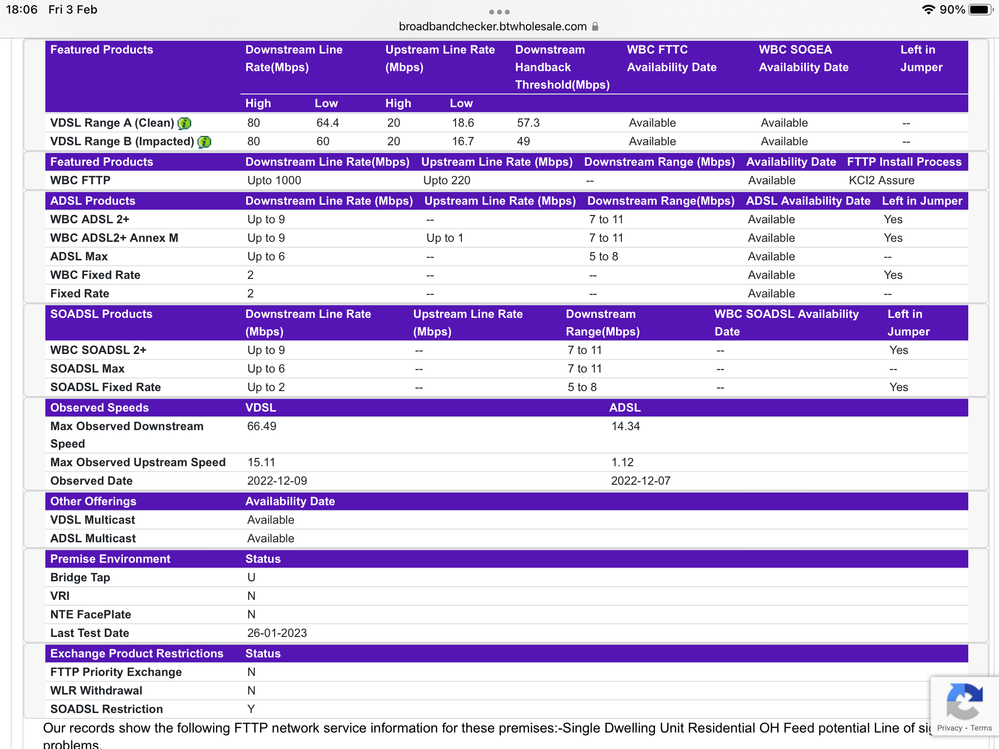

silver
Posts: 68
Thanks: 6
Registered: ‎26-06-2014
Re: Not getting guaranteed minimum speed and no help from plusnet
silver
Posts: 68
Thanks: 6
Hope those images make sense to you. Thanks.
Posts: 25,154
Thanks: 9,081
Fixes: 387
@silver They make sense - and the last 'observed spedd' which is to the test socket of your master socket, on 09/12/22 was 66.5Mb/s, so your speedtests should be retuning figures in the high 50's - 55mb/s ish.
