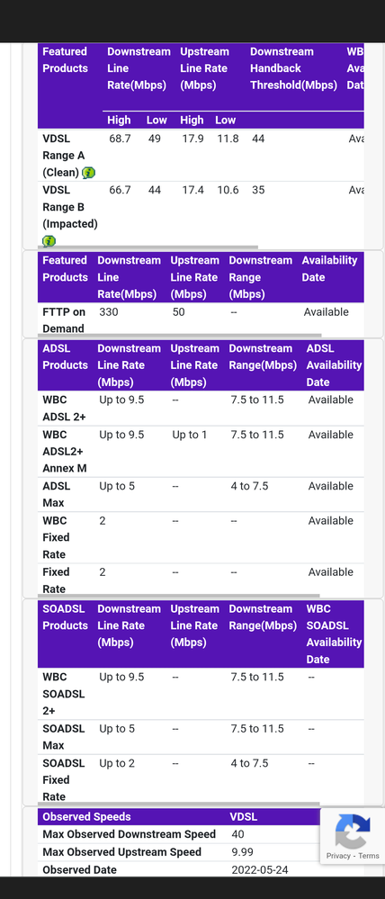

@mobymatt Welcome to the forums. Did you sign up for 'Unlimited fibre' or 'Unlimited fibre Extra'. Screen shots of BT Broadband  and BTW Performance Tester would be useful.

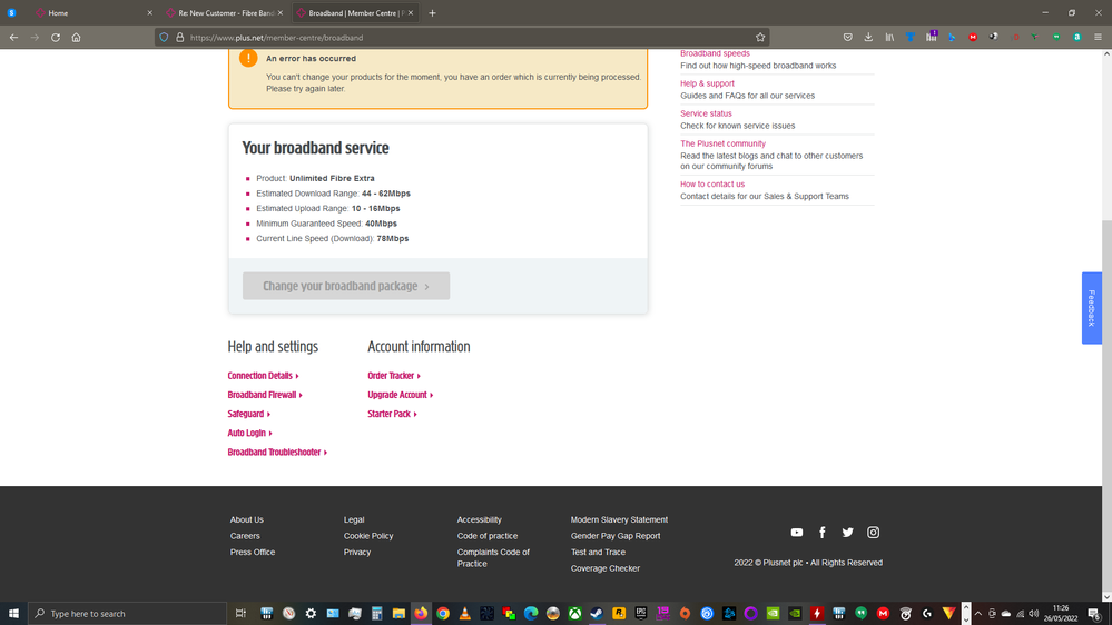

Looks like the browser was the issue. I am on Fibre Extra.

Are you sure you are on Fibre Extra - those results look like the 40/10 - basic fibre - to me.

Yup - you are on Extra, but it looks like something has gone wrong - even with what looks to be a longish 'final mile' of copper, those figures suggest an error somewhere. This needs PN Help Team investigation.

When I was with Sky I used to get in the high 50's / low 60's, but had a problem about 9 months ago that caused disconnections and a speed drop. I eventually found it was a cable fault and changed it. I then saw an increase but as soon as it hit dead-on 40 then no more increases. As this was over 33 there would be no incentive for Sky to push it.
I think the line is banded, and that Openreach have not removed it to allow for DLM to do it's thing.

It may be a 'banded' case, but this will need to be confirmed by one of the Help Team.
