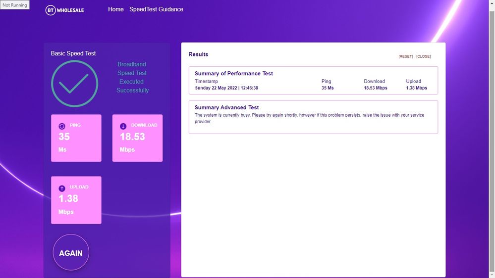

Ok re-ran the tests. Unfortunately Additional diagnostics isn't available at the moment. Even the upload has dropped from 1.7mbps.

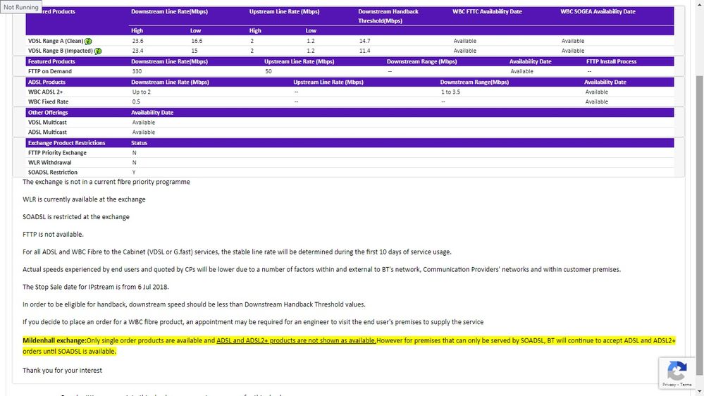

@ashyt16 looking at BT Wholesale link (2nd pic) you are way away from your Fibre cab, and unfortunately the speeds do drop off markedly over relatively small distances. You are above the Handback threshold, so there is little or nothing that BT/OR will (or realistically can) do about the situation.
