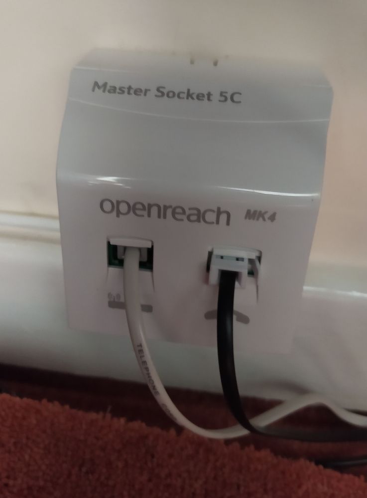

a) I carried out a quiet line test and the line is silent.
b) The hub is plugged directly into a twin socket Openreach MK4 Master Socket 5C.
c) I am using an ethernet cable connection, not Wi-Fi.
Nothing has changed here since the socket was installed new on 15th January and I was wondering if there is a setting at Plusnet's end that is causing it?

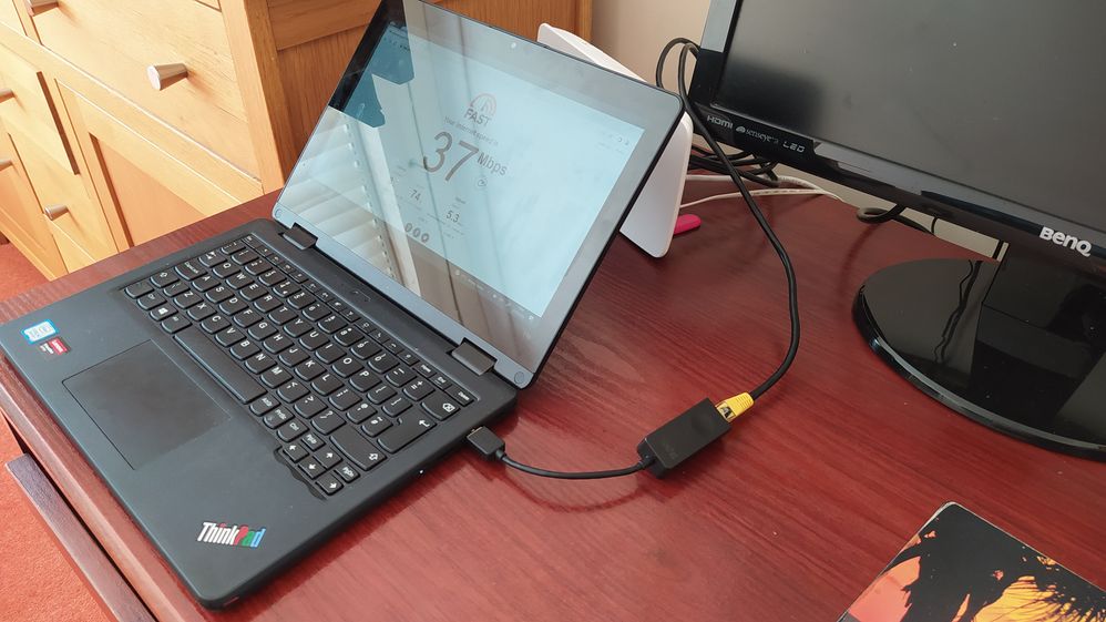

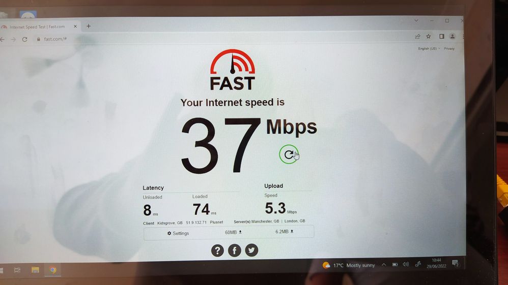

The Qube engineer visited this morning and confirmed the cabling and Master socket were new and he hard wired his laptop into my Plusnet Hub One. His speed test checks confirmed the slow upload speed issue. He got only 5.3 Mbps upload speed over several tests. He said it was unlikely to be an internal issue. The problem is getting worse. See photos: -

Thanks for the update, sorry that's still an issue and at least we've been able to rule out some of the more obvious causes. It would be best if we get an Openreach engineer to come out next. Can you let me know if you're available in one of the following slots which we can book in Monday to Friday?

I note that you have a 5C master socket with a Mk4 faceplate. It's not unknown for the faceplate to be faulty. Did the Qube engineer unclip the faceplate and test the sync speed from the test socket using a filter to see if there was any improvement ?

No, the Qube engineer simply plugged his laptop into my Plusnet Hub One.
