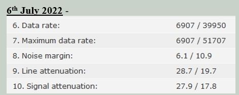

Results of Openreach engineer visit today: - She found zero line faults anywhere all the way back to the exchange thereby eliminating the line as the culprit. She replaced the Master Socket filter plate as a precaution and all Network Adapter drivers are up-to-date so I am wondering if it could be a fault with the Hub One itself? If you compare the Helpdesk lines 6 and 7 figures you can see a 22.8% reduction in data rate between 14th January and 6th July. Any thoughts anyone?

I note that there is a 10% increase in US line attenuation. I suspect that has some contribution to different US sync speed which is being. What might give rise to the observed change in line attenuation is not within my expertise. Possibly one for @198kHz
